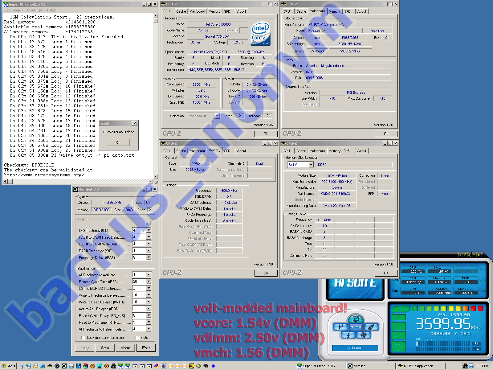

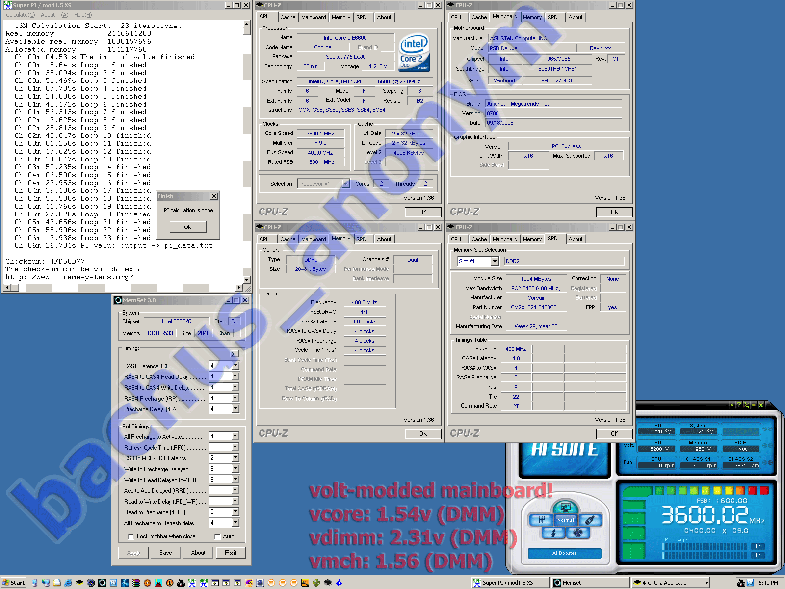

Regarding the hidden bios setting referred to in an earlier post, well, that would have to be one helluva tweak to make up 18 seconds in 8M (see first post in this thread). I have my doubts about that.
wow, it blows me away the differences in 3d01 lobby and 3d03 the dogfight.
Awesome results with 3D01 Lobby and 3D03 WoF... High Bandwidth wipes the floor with 8-2-3-3.0! Difference is just huge! I'm pretty sure that TRCD=2 would help some for Fatbody, but still bandwidth rules, it seems :)
Thanks for your hard work, man! :toast:

Heres some more...
kinda to help those wondering, is running 367 at 3:5 better, then running 1:1 at tight latencies better...
7 x 367 Vs. 6 x 428.

Nice comparisson Kunaak. Looks like Mhz wins on 965.
1:1 generally works better with 975X platform because of the way the straps are set. With the P5B Dlx, if you boot into Windows above 400FSB you are on a looser strap. The same is not true for most 975X boards. The advantage of 965 boards is that they will hit higher memory speeds, with reasonable voltage. And as the tests in this thread have shown, high RAM speed will beat 1:1 and tighter timings, at least on the 965 platform.
I use both 965 and 975X. There are things I like about each. But you can't draw conclusions about the 965 platform, based on your experience with 975X. The opposite is also true.
1:1 being faster than 4:5 or 2:3 seems to be 975x "problem" then. I have not run 3D01 (I might try soon, though) but a while ago I compared SPi16M and 4:5, 2:3 was sure noticeably faster than 1:1 :fact:
So, like sierra says, what is true for 975x may not (and probably will not) be the same for 965P...
