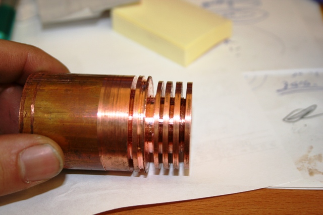

I was trying to make an evap from a bar of 38mm solid copper.Quote:

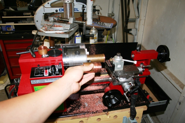

This is the lathe I was using. Sorry I only have this and 1 other picture a little closer up. (Phones are banned from our school so I have to be quick so I dont get caught :p: . Its also only a 2mega-pixel camera on the phone :) ).

Well quite frankely... most of lathe should be able to handle it if tool is set correctly (even few thousandth of height or alignment on lathe seem to make huge difference) on parting... especially on copper -__-;
Here is the lathe I have, it's more for R&D and for finishing up not so good finished evap or sleeve for exact fit I like. Backlash has been adjusted to about 2 thousandth... Only bad thing is, I have some play on the table itself which I can't figure out how to fix short of making new gib for it that has better tolerance... -_-; I believe this probably is cheapest lathe you can find ahaha...(it's commonly called 7x10 mini lathe)
http://vapoli.com/images/Forum/IMG_8972.jpg
Here is what I played around with recently just for toying around using it. Of course, I was cussing myself every minute or so complaining how underpowered this lathe is. I ended up grinding the tool to reduce friction as much as I could so the small dinky motor won't just keep stop. It has self preserving feature to prevent major disaster from happening which in this case was slowing me down a lot.
http://vapoli.com/images/Forum/IMG_8973.jpg
Nope, I have no intention of doing more than few once in a while just to remind myself not to use this lathe for this use... :) But for those with patience and want to DIY, lathe is relatively inexpensive to toy around until you start upgrading things... :)
Im sure the parting tool was set correctly. My teacher checked it many times and said it should be fine.
Anyway, this is what I ended up with after running out of time. I had to take the bar out the lathe and saw the evap off with a hand saw:mad: . Thats why you can see a small ledge on the right side.
Btw this was supposed to be a stepper evap. I didn't bother using it because I doubt I could find a sleeve to fit it properly.

brett looks like your bit ground wrong or height is wrong, its chattering for you.
are you using the tail stock?
sorry my english dont help-me can you explain better? :SQuote:
Originally Posted by wdrzal
are you talking about the tall of evap?
:toast:
No he means the spindle that is at back of actual spindle turning for lathe job. For parting cuts, it is recommended NOT to use tail stock as part are meant to be fallen off instead of getting crunched in between when job is done and potentially breaking parting tool, flying, out, hurting someone, etc.Quote:
Originally Posted by |RickY|
but during the cutting opteration you USE the tail stock ,especially if you have a lot of chatter. you may also need to adust the ways on the slide and cross slide.
looks like bit may be dull or ground wrong.
sorry can't teach that in words.
