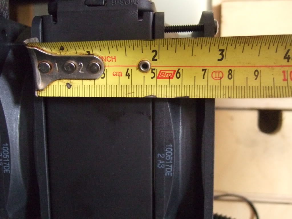

But can I ask you another favor. What is the measurement from the top fan screw holes to the top of the radiator, and from the botton fan screw hole to the bottom of the radiator? Thanks man :up:
Also, why does everyone say it's 50mm thick if it only measures 48mm? :shrug:

The distance from the centre of the rad screw hole to both the top and bottom is the same distance: 22mm. When it is mounted with the extrusions above and below then both sides are exactly the same width as the fans: 120mm.
So you need at least 22mm clearance on two opposite sides of the mount :yepp:
No idea lol :D
It is definitely 48mm ;)

Do you have any other ruler with metric?
It was posted by a reviewer here as 50mm
http://www.gdm.or.jp/review/corsair_...age/19_450.jpg
http://www.gdm.or.jp/review/corsair_...age/20_450.jpg
Scares me how popular this thread is.... :sofa:
the divets or whatever they are called that hold the tip to the tape, are clearly able to move by about 1mm
its damn well close enough to 2" i think everyone can calm down
First: To be even remotely accurate the tongue of the tape measure would have to be OVER the edge of the radiator, not just pressed into the gap of the curved edge and the fan.
Second: The cut at the start of the tape is curved.
Third: There is obvious play between the rivets holding the tongue to the tape.
All this before we get to 30mm, sure the accuracy might improve a whole lot once you get to the 50cm mark but at the 50mm point it's not trustworthy.
