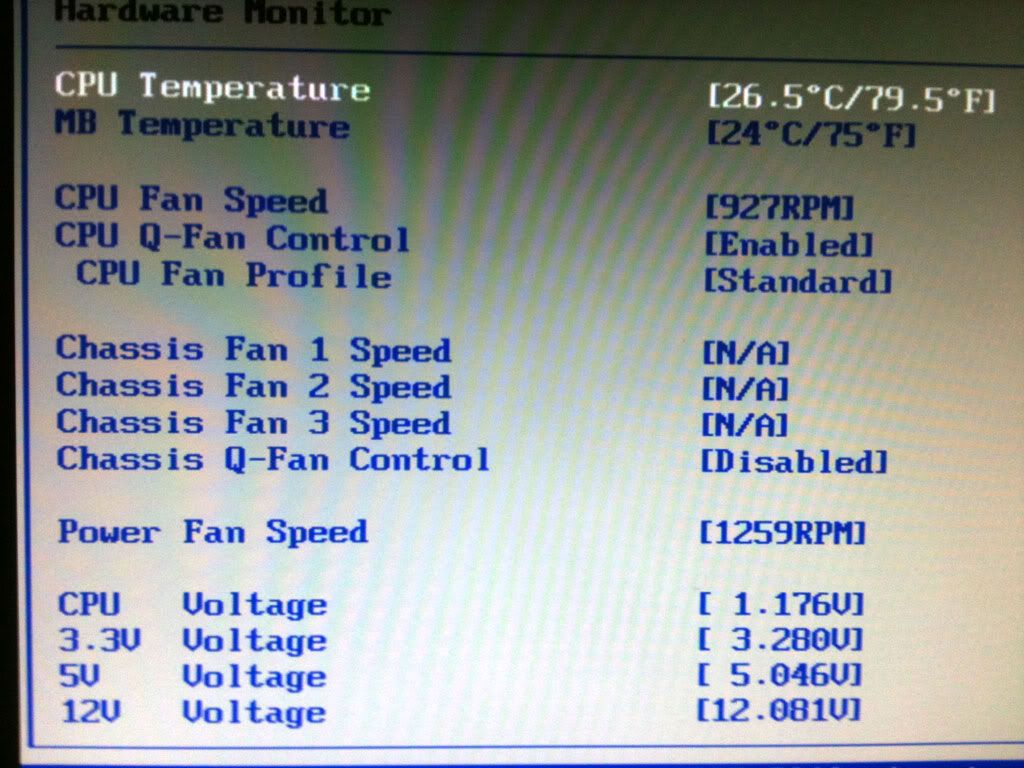

ok guys, i just finished building my pc yesterday, after installing windows seven and trying to see how stable the system is with few programs i must say i am very happy with it .. specially with the noctua performance keeping the cpu temp at 39 C ( while playing Battlefield bad company 2 ) and very impressed when i was running Austodesk Maya Rendering and particle simulation, and it does keep the cpu at 21 C (70 F) idle time .. however i just noticed the middle fan of the cooler trying to start then stop .. trying to start then stop .. i m using the Ultra-Low-Noise Adaptor (U.L.N.A.) connecters and they are connected to each fan wire, and they are both connected to different fan pins on the asus motherboard
the funny thing is sometimes when i start the pc it does start .. sometimes ... it keeps trying ( the middle 1400 fan ) .. there is no overclocking yet .. just testing the system for now
Everest report : Mobo Temp = 25C / CPU Temp = 21 C / Cooling Fans = 917 RPM
anybody experienced such a thing before ?
Do you have Q-Fan enabled in bios?
Are the two ULNA attached to their corresponding fan?
Sounds to me like you have Q-Fan enabled. That with the ULNA adapter isn't giving the 140mm fan enough volts to start.
i removed the ULNA adapter for the 140mm and actually its working ok now, i just enabled the Q-Fan control in the mobo, altho i guess Everest is showing me the 120mm RPM not the 140mm ?
