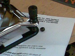

No other mishaps surely? Wrong again. Boy am I glad I had a good look at the backplate because the damn thing is broken. One of the press fitted screw hole pillars has literally just fallen out. I say press fitted as theres no other sign of any other join - infact both surfaces were rusty. Score now down to what, a 4 maybe? I've checked the other three, one is fixed firmly and doesnt move at all, one is a little loose and moves in a couple of directions, the third is very loose and is easily and fully moveable up and down in the backplate.

I'll get a better pic of this later as the Mrs. digicam battery is flat, but this should suffice for now (useless 2mp nokia 6300):
http://i169.photobucket.com/albums/u...T/Image051.jpg
