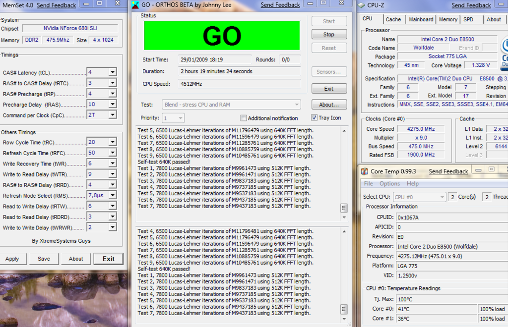

Well I'll be dayumed!! So far so good - after four hours in the Freezer followed by a quick blast from my wife's hair dryer, I have one stick happily priming 900MHz 4-4-4-12 at 2.1v. Before, neither stick would work even at 800mhz 4-4-4-12 2.1v. One down, one to go...
Update: All four sticks of Cellshock in now (2G 8000 C5 and 2G 8000 C4) and did dual Spi 32M at 900MHz 4-3-3-10 2.1v
The dilemma now is should I keep the sticks or ask for a refund? I don't know how long this "recovery" will last, and I'm going to try Orthos at 900MHz 4-3-3-10. I bought the OCZ XTC memory cooler specifically for my 4x1GB of GKX so I hope I get a decent 24/7 OC from these kits at 2.2v max. :yepp:
Update #2: Orthos is happy as larry at 900MHz 4-3-3-10, 2.1v. Going to do more overclocking. :D

SUCCESS! :up: After four hours in the freezer my 8000 C4 sticks are right at home with my 8000 C5 kit, 950MHz 4-3-4-10 on 2.15v bios :cool:
http://i293.photobucket.com/albums/m...x1gbcas434.png

http://img684.imageshack.us/img684/9641/btuklcc.png Way better than before as well :rofl:
