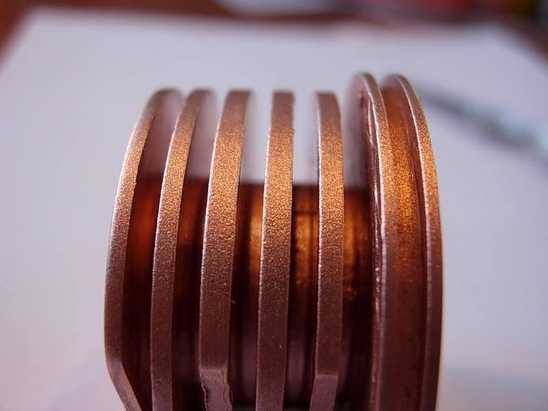

Tyber your braze on evaps doesn't look like they are flowing the filler out uniformly. What rod are you using ? are you cleaning first and using flux????
Some one could teach you how to make perfect brazes in 15 minutes if you could get with someone that knows how. It's hard to explain in words,but a few quick lessons and you'll be a pro.
Good luck
Walt
ya i am with wdrzal it seems like you are not getting it hot enough but then again you real can't tell by pics. i wish you lived by me i could show you a trick or two but still looks good keep it up and you will get the brazeing before you know it. hope to here from you soon. Brad
thanks but i am happy with how i sweat. care to show the areas where it doesn't seem to flow?
OK sorry i did not say that right it just looks like ether you had to put alot of braze rod on it or that it just was not flowing right
and the other reason i would say this is because you should be able to take off all the excess braze and not have it leak as it should suck into all the joints.
and when ever this would happen to me i would just add more heat to get it to flow into all the joints.
now i am not saying you are doing anything wrong its just it takes some time to be a pro at it
not saying i am a pro as i have only been brazing/welding for 5 years and still have lots to learn.
or is this not what you ment when you said
here are the pics. after the wait i didn't want to have to leak test it again and risk leaks by completely getting all the silfos off
or did you not have any leaks last time and you are just covering your butt to make sure it does not leak. and if that is the fact i take back all i have said as now i know that you just put on more brazing rod then what you needed to make sure it did not leak.
hey i didn't take offense to it. This evap had a pin-hole leak last time and i wanted to make sure i got it this time. If you guys are referring to how much the silfos is climbing up the evap is because... i wanted to make sure i didn't have a leak heheh.
I am arrogant and still braze in a vice which im sure doesn't help. At the price of kiln brick around me or to ship it it would problably be best to just buy a cheap camping stove and braze on it.
cheers
It just looks like the braze isn't flowing out evenly. It looks like there is a lot of thickness, although a fraction of a millimeter, you might not be getting the capillary effect. This may lead to a braze that isn't as strong since the thick braze material is simply gaping across the two pieces of metal. Like ruffus said you can't really tell by a pic and if you look at the area above the red box it looks completely smooth. Either way, I think you are doing a fine job on those evaps.
Joe
p.s. Are you heating from the top or bottom?
cheers joe!
btw i found a picture on my camera from ~ a month ago with the evap just after brazing
http://i198.photobucket.com/albums/a...r/DSCN2647.jpg
edit: joe, i have the base facing the sky and heat the base until the evap gets very hot, then work around the sides till it glows orange

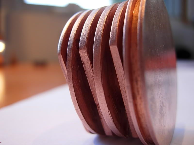

also look what i did today. the granddaddy of all evaps :p: not including blasters hehe. its larger diameter, huge, and will be great for a cascade. its not nearly complete, got loads of machinign to do. (i.e. havn't even touched the base yet... it will be machined as thin as i can get it, hopefully as thin as the oether evap in the picture)
http://i198.photobucket.com/albums/a...r/DSCN2779.jpg
http://i198.photobucket.com/albums/a...r/DSCN2781.jpg
http://i198.photobucket.com/albums/a...r/DSCN2782.jpg
i think it will be sweet for a cascade LOL! its priceless... its taken me many hours to get where i am
looks good keep up the good work
Damn that thing looks like it eats CPU's for breakfast.
Good Job.
O ya and, Any particular reason for thin channels but thick copper in between?

Hey Teyber looking at the design again I have a couple of questions:
1) The cap line goes in the top spraying refrigerant onto the top circle and then pulls down to the suction at the bottom at the cut edges correct?
2) Are the circles angled downwards to aid in the flow and suction or are they straight?
http://i198.photobucket.com/albums/a...r/DSCN2926.jpg
hey!
1) no the cap tube goes to the base layer then the suction is at the top.
2) i would need a 5 axis cnc mill or a lathe to do angled slots.
cheers!

so guys last night i stayed up late to see if i could get the test rig up and running. so after i got it charged with r290 it was running just great i was getting -33c at 200 watts then all of a sudinht e low side sucked into vacuum as well the high side droped as well. so i was thinking at frist muck i have a leak. so i shut it off and looked for any leaks with leakdetector stuff and could not find any. So when i found there was no leaks i got down to thinking what could cause this to happen. now does anyone have a idea what might be happening here. as at first i thought maybe it was a blocked cap tube but if it was that the high side would have gone up instead it got lower.oh ya as well after it does this and i shut it down the sides don't equlize. here i will give u guys the model number of the compressor maybe there is something i am missing
not to sure what is up with this thing as i get up this morning and now it seems to be working so i am going to leave it running and see if it does this again
finally invested in a blaster. not perfect but here is try #1 wit a totally ghetto setup :) (no cabinet, not enough air, too fine of grit)

all previous blasting was done by ruffus(better then me lol) but shipping was starting to add up
so this is the first blasting done by yours truly :)
she look great teyber work of art mate well done
see teyber I told you some sand blasting equipement is cheap make yourself a ghetto blaster cabinet and after a while you will have it down
good job man
