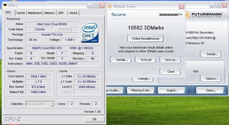

got a gecube x1950pro to play with..
x1950pro @ stock setting
http://i75.photobucket.com/albums/i2...dmark10582.jpg

Guys I was overclocking last night and running 3dmark 2006 and on 1st test I was getting 50k 49k 47k etc. then it goes to about half that. then in the 2nd test firefly forest I am getting like 16fps? it just kept getting worse. Is this a heat issue? there were no visual artifacts but as the benchmark progressed my fps kept dropping. finally my score is like 6500 in crossfire 641/810 641/756 and the optimal mem timings. Any ideas? My score at stock is about 7.5k in 2006
Firefly forest is the rude test and usually the FPS are about the half (or less) compared with the Canon Flight and Proxycoon test.
It seems like there is no heat issue there.
you said when OCing youve got 6500 and with stock cards youve got 7,500?
If yes, then, it should be a problem, what PSU do you have?

as for my 2006 results..take a look at this. The results are pretty disturbing
i'm using an ocz powerstream 520w

Do you think its a psu issue?
Your PSU is on it's limits when running Crossfire at overclocked cards.Quote:
Originally Posted by trans am
I increased the pots on the back of the psu a little.Quote:
Originally Posted by Spacehead
still really crappy firefly scores!! All other tests were much better than my previous 2006 scores but firefly is just terrible!
how the hell was I geting 27fps in firefly before?

Adjusting voltage won't give you more power. If your scores increased, then your PSU can''t handle crossfire. Consider OCZ GameXstream 700WQuote:
Note Trans Am....you have the same core OC that I have, 661. I think that this clock has reached our voltage limit for our cards, as I don't have temperature issues at all at this clock. I have my memory at 832 stable.
