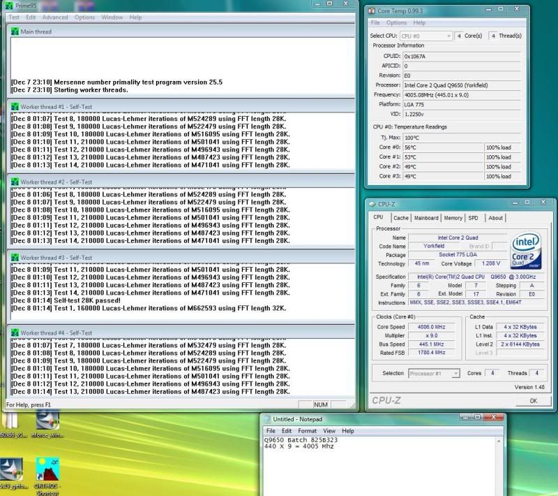

Remember on this board your mch ref tracks your vtt voltage not the mch voltage like it should. So if you change vtt or mch voltage a couple steps apart you may have to readjust the mch reference. This is what I used for 4.35, my chip is a low vid so you may or may not be able to use my vcore. And for the psu mod, I dont bite on that one, I was using an 850 rosewill for a long time and had no problems with going up to 5ghz or stablity.
Code:******Motherboard Intelligent Tweaker (M.I.T.)******
Robust Graphics Booster.........................[ Auto ]
CPU Clock Ratio.................................[ 9 ]
Fine CPU Clock Ratio............................[ + 0.0 ]
CPU Frequency 4.35GHz...........................[ 483 x 9.0]
******Clock Chip Control******
CPU Host Clock Control..........................[ Enabled ]
CPU Host Frequency (Mhz)........................[ 483 ]
PCI Express Frequency (Mhz).....................[ 100 ]
C.I.A 2.........................................[ Disabled ]
******Advanced Clock Control******
CPU Clock Drive.................................[ 800mv ]
PCI Express Clock Drive.........................[ 900mv ]
CPU Clock Skew..................................[ 0ps ]
MCH Clock Skew..................................[ 0ps ]
******DRAM Performance Control******
Performance Enhance.............................[ Standard ]
(G) MCH Frequency Latch.........................[ 333 ]
System Memory Multipler.........................[ 2.40B ]
Memory Frequency 1066...........................[ 1159 ]
DRAM Timing Selectable..........................[ Manual ]
CAS Latency Time................................[ 5 ]
tRCD............................................[ 6 ]
tRP.............................................[ 5 ]
tRAS............................................[ 15 ]
******Advanced Timing Control******
tRRD[3].........................................[ 3 ]
tWTR[3].........................................[ 3 ]
tWR[6]..........................................[ 6 ]
tRFC[54]........................................[ 54 ]
tRTP[3].........................................[ 3 ]
Command Rate (cmd)[0]...........................[ 2T ]
******Channel A Timing Settings******
Static tRead Value [ 8 ] ................[ 8 ]
tRD Phase0 Adjustment [ 0 ] ................[ Auto ]
tRD Phase1 Adjustment [ 0 ] ................[ Auto ]
tRD Phase2 Adjustment [ 0 ] ................[ Auto ]
tRD Phase3 Adjustment [ 0 ] ................[ Auto ]
tRD 2rd (Differnt Rank) [ 6 ] ................[ Auto ]
tWR 2wr (Differnt Rank) [ 6 ] ................[ Auto ]
tWR 2rd (Differnt Rank) [ 5 ] ................[ Auto ]
tRD 2wr (Same/Difft Rank) [ 8 ] ................[ Auto ]
Dimm 1 Clock Skew Control.......................[ Auto ]
Dimm 2 Clock Skew Control.......................[ Auto ]
DDR Write Training..............................[ Enabled ]
******Channel A Driving Settings******
Drive Strength Profile..........................[ 1066 ]
Data Driving Pull Up Level......................[ Auto ]
cmd Driving Pull Up Level.......................[ Auto ]
ctrl Driving Pull Up Level......................[ Auto ]
clk Driving Pull Up Level.......................[ Auto ]
Data Driving Pull Down Level....................[ Auto ]
cmd Driving Pull Down Level.....................[ Auto ]
ctrl Driving Pull Down Level....................[ Auto ]
clk Driving Pull Down Level.....................[ Auto ]
******Channel B Timing Settings******
******Channel B Driving Settings******
******Motherboard Voltage Control******
Load-Line Calibration...........................[ Enabled ]
CPU Vcore [ 1.15 ]...................[ 1.36875 ]
CPU Termination [ 1.20 ]...................[ 1.280 ]
CPU PLL [ 1.50 ]...................[ 1.500 ]
CPU Reference [ 0.760 ]...................[ 0.835 ]
MCH Core [ 1.100 ]...................[ 1.300 ]
MCH Reference [ 0.760 ]...................[ 0.850 ]
MCH/DRAM Refernce [ 0.900 ]...................[ 1.110 ]
ICH I/O [ 1.500 ]...................[ 1.500 ]
ICH Core [ 1.100 ]...................[ 1.100 ]
DRAM Voltage [ 1.800 ]...................[ 2.220 ]
DRAM Termination [ 0.900 ]...................[ 1.110 ]
Channel A Ref [ 0.900 ]...................[ 1.110 ]
Channel B Ref [ 0.900 ]...................[ 1.110 ]
******Advanced BIOS Features******
Limit CPUID Max to 3............................[ Disabled ]
No-Execute memory Protect.......................[ Disabled ]
CPU Enhance Halt (CIE)..........................[ Disabled ]
C2/C2E State Support............................[ Disabled ]
C4/C4E State Support............................[ Disabled ]
CPU Thermal Monitor.............................[ Disabled ]
CPU EIST Function...............................[ Disabled ]
Virtualization Technology.......................[ Disabled ]
