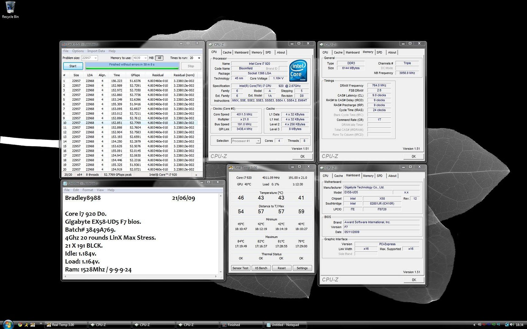

My baby :)
http://img43.imageshack.us/img43/2425/s5002485.jpg
http://img208.imageshack.us/img208/3586/beztytuusjg.jpg

hmmm seem to be that batch "38xxxxx" is better than "39xxxxx" isn't it????
Batch 3845B271
http://img171.imageshack.us/img171/3350/temps43.th.jpg
Was not stable doing 4.3 @ 1.3V with HT ON but is fully stable @ 1.31v.. But have not done much fine tuning yet.
Will upload screenshot soon :)
