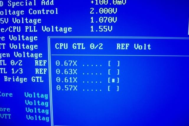

Northbridge GTL: 0.67 (posible values: 0.61 & 0.67, with 0.67 is unstable)
Posible values:
http://i770.photobucket.com/albums/x...l/Dsc09855.jpg
testing....

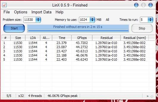

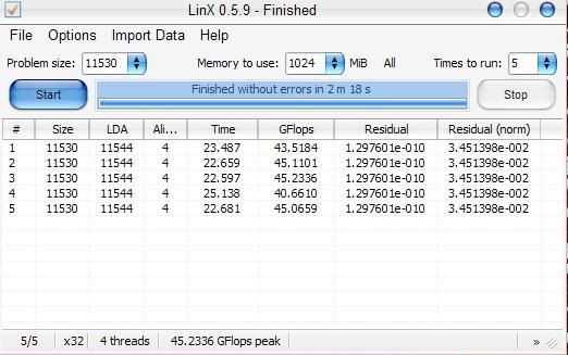

CPU GTL 0/2 REF Volt - 57
CPU GTL 1/3 REF Volt - 61
http://i770.photobucket.com/albums/x...real/5761b.jpg
CPU GTL 0/2 REF Volt - 61
http://i770.photobucket.com/albums/x...eal/061061.jpg
CPU GTL 0/2 REF Volt - 63
http://i770.photobucket.com/albums/x...nreal/6361.jpg
CPU GTL 0/2 REF Volt - 67
http://i770.photobucket.com/albums/x...nreal/6761.jpg
CPU GTL 1/3 REF Volt - 67
http://i770.photobucket.com/albums/x...nreal/6357.jpg
CPU GTL 1/3 REF Volt - 57
http://i770.photobucket.com/albums/x...nreal/6757.jpg
Thats all for now....
Q9550 E0 batch L848C436
Asus P5Q-E
GTL0/2 - 0,67
GTL1/3 - 0,65
VPLL - 1,52
VTT - 1,22
VDDR - 2,00
VNB - 1,24
VSB - 1,1
VPCI - 1,5
http://img2.imageshack.us/img2/803/test1c.th.jpg
That setting there looked to be your most stable spot for you from what I am looking at. I think your motherboard just can't handle much more at this point. You should get the UD3P motherboard board for higher FSB on that chip. In other words that might be the highest GFlops your motherboard will let your CPU push it looks like... that is if, everything is stable.

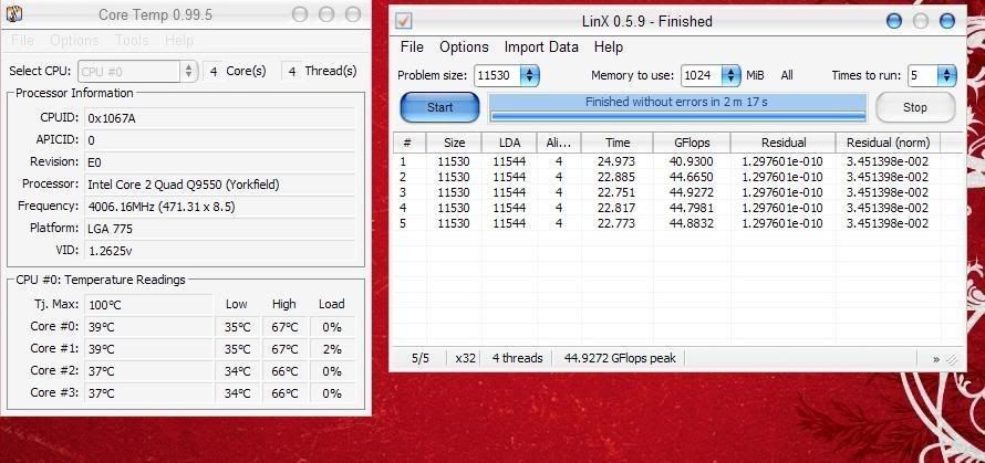

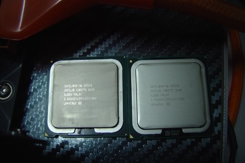

Another E0 (the right one):
http://i770.photobucket.com/albums/x...l/Dsc09872.jpg
The VID is 1.22v, instead of 1.26v of the other.
And is cooler, around 4-5º less:
http://i770.photobucket.com/albums/x.../Dibujo-15.png
Nope, around 60-65º al max with Linx.

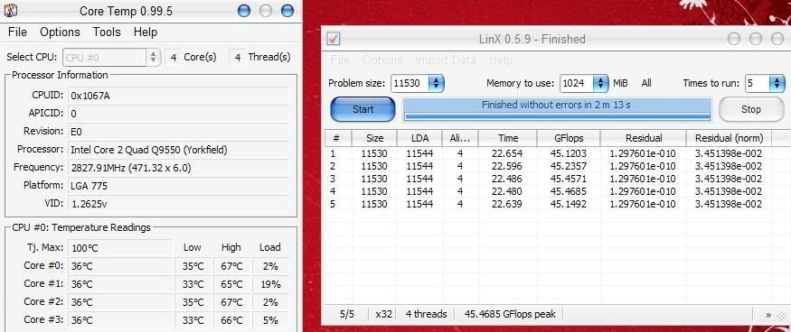

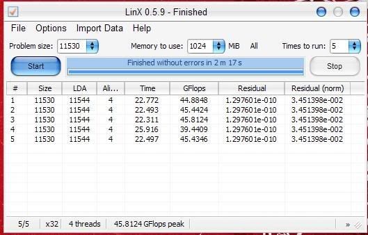

Got an Q9550 sinds 2 little weeks.
My Goal was a min of 3800mhz becos i hade a Q6600 @ 3400mhz already.
This was my first atempt
Bios :
Fsb : 459
pci : 101
Mem : 1/1
Vcore @ 1.2.56
Mch @ 1.3.40
Ram @2.1
http://i38.tinypic.com/23m3fxg.jpg

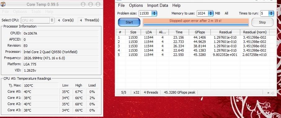

So went furter with this :
Fsb : 471
Pci : 101
Mem : 1/1 5/5/5/15
Vcore @ 1.2.625
Mch @ 1.3.60
Ram @ 2.1
http://i36.tinypic.com/169f3fk.jpg
This is all on my shiny new Gigabyte p45 board.
I m looking forward for the 4100mhz.
Tips are welcome ;)
DER.DAAS
@DAAS
You can try to lower your MCH Core to 1.32v @ 471 FSB
What CPU Termination and PLL you use?
Can you post screenshot from ET6 settings
All the rest of the settings are set @ normal in bios i didnt touch anything just putted them on normal what the Gigabyte Ud3 uses.
Is this enough info ore shall i look later this weekend for the exact numbers ?
And shall try out the Mch lowering. :):)
DER.DAAS

Or it could be his GTLs are not set right `100%. I think he should try to mess with those before throwing in the towel. I mentioned this a couple pages back. GTLs directly affect your CPU temps. Watch your temps after changing a GTL setting and while in mid intelburntest or linx testing and you will see what I am talking about. You want to try to settle your GTL settings where the temps are the highest and most even for all cores and your CPU passes the test of course.
That is interesting, Never knew GTLs could have such a big effect. I will mess around with those in a little bit, I should be getting my Megahalem in the mail today. Right now it is happy at .66 for both cores.
