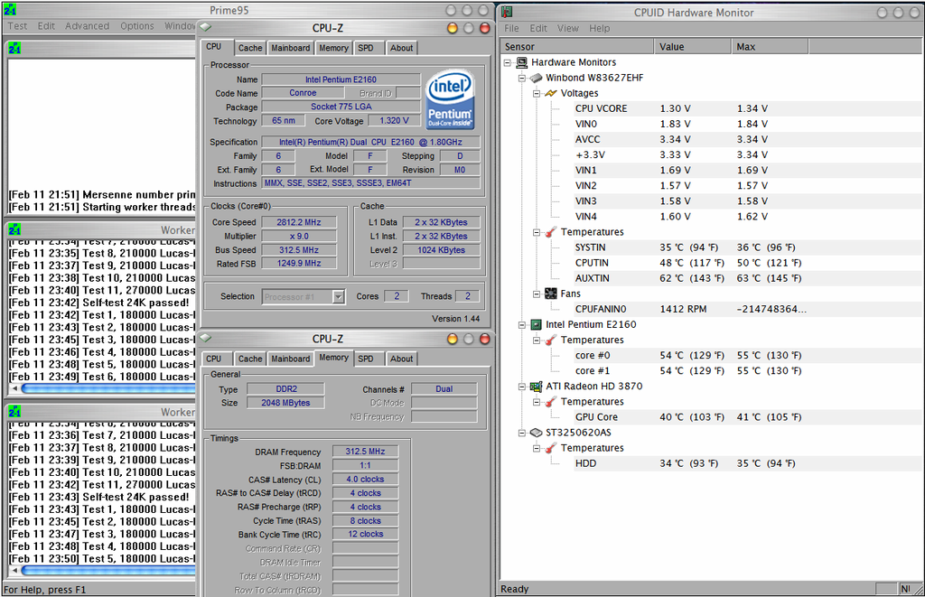

Seems no one has posted a E2160 in this thread so far so here goes. Finally demoted the P5W from main rig so bought a cheap cpu for it and running at Auto Vcore - one of my main dislikes about this mobo's BIOS since I prefer to have EIST/C1E active. Using XP90c, AC Ryan 120mm fan and Kingston VR D9DCL sticks (2.0V), Prime95 stable >2hrs. Couldn't even reach 9 x 333FSB with OCCT stability at Auto Vcore, pity!
http://i173.photobucket.com/albums/w...Prime95_OK.png
