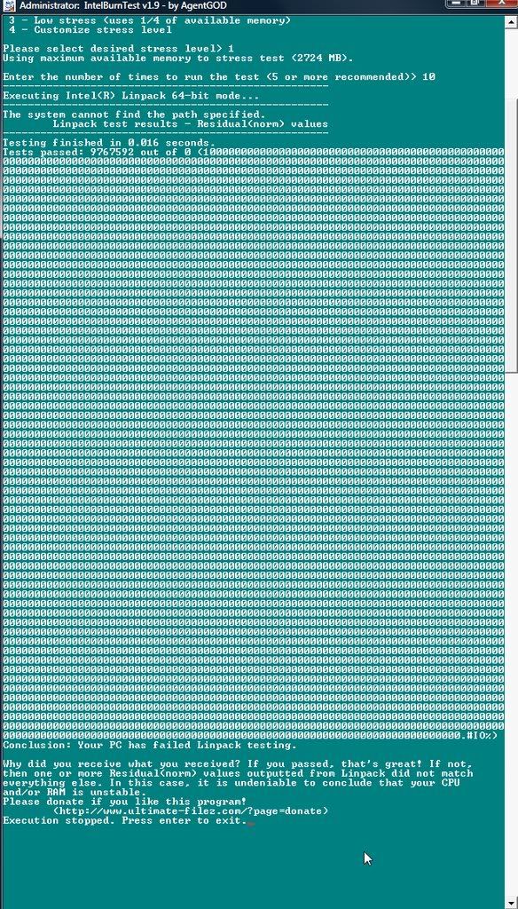

wow it failed a max test of 10 in less than one sec ???
but ive tested on occt for almost 4 hours stable?
could it be an error? i mean in less than one sec?
damn i really thought i was stable here.

im not doubting its correct. im just shocked it found an error in less than a second while other progs would take hours.
maybe im using it wrong?
http://i295.photobucket.com/albums/m...eenShot007.jpg
thats exactly what mine looked like. but now when i tried it seems to work fine,could it be that it was not totally stable?
That only happens when you don't have everything in the same folder.
Let me emphasize this again: you MUST extract everything from the zip to the SAME folder while maintaining the original directory structure, or it will not work at all, and it will look like that when you try to run a test.
thanks agent. i suspected i did something wrong there.
as soon as i finish a game on bf2 ill dl it again and reinstalling it like u say. see if works.

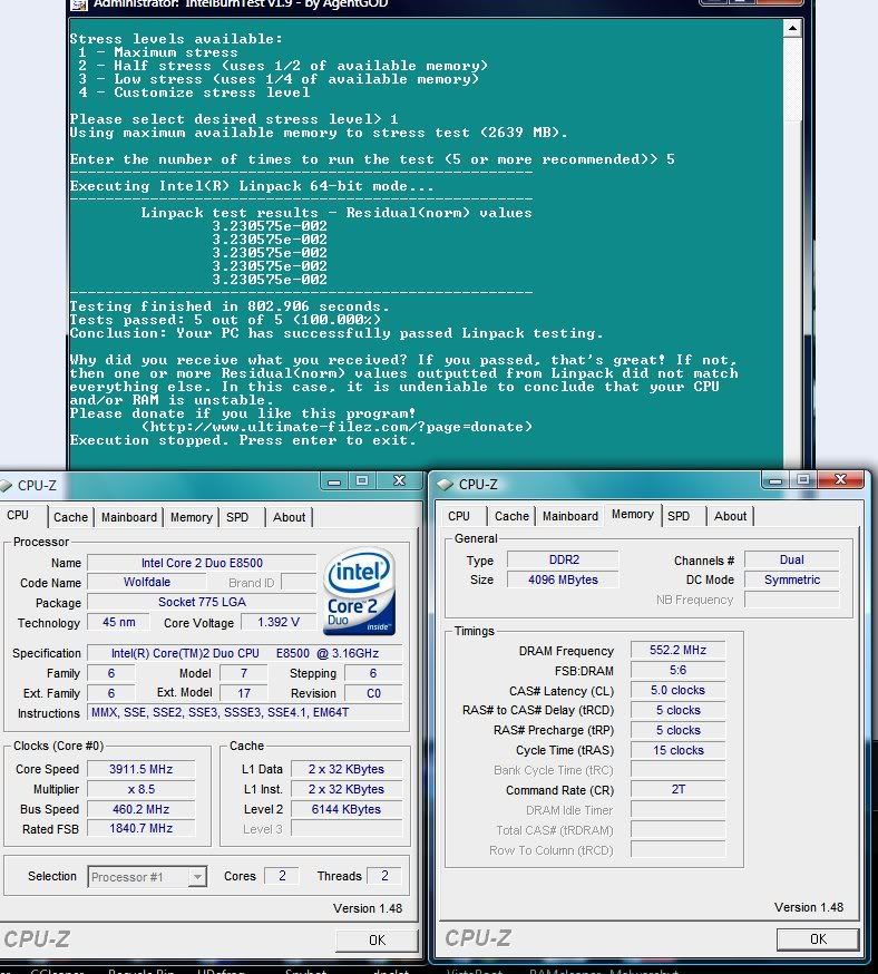

was getting fails at first on the 5th run, but after adjusting vtt and gtls from 1.45v to 1.3v ,93/90/70 i finally got 5runs stable :up: sometimes less is more i guess.
http://i295.photobucket.com/albums/m...eenShot010.jpg
10 runs is even better :P
