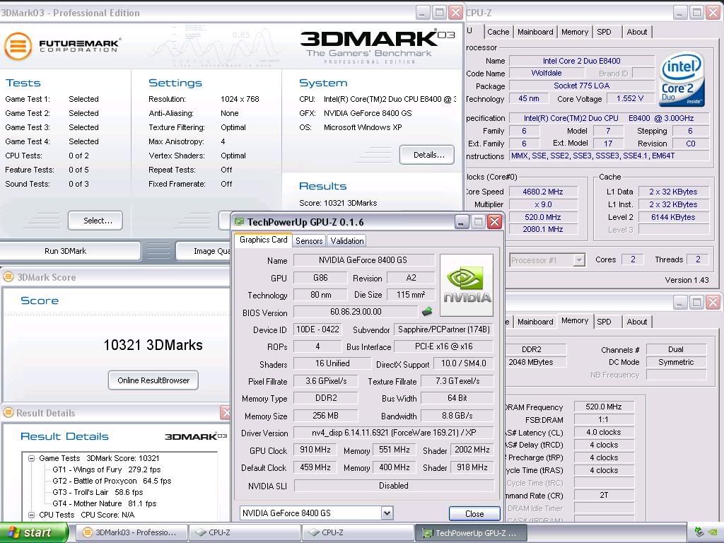

Not sure how much more benching time I'll get, posting an '03 backup ;)
'03 ORB link
http://img.photobucket.com/albums/v3...y/03_10321.jpg
Squeaked into #1 for 03 with that backup, wonder if SpikeP has a backup too? :toast:

on the same day i benched through with this score. Left it till someone broke the last one. not a drastic increase, but still gets me back up there :up:
http://img141.imageshack.us/img141/4194/10427en9.jpg
GHZ is quicker in GT1 and GT4. I am faster in GT2 and GT3, so interesting!
