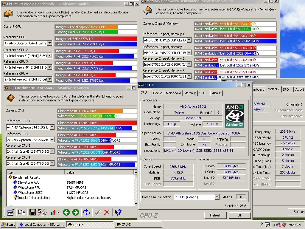

When your testing for stability make sure you do some runs with p95 on large inplace fft's... i primed 14 hours on the small inplace ffts at 2640mhz or so, no problem.. but within 15 minutes of running large ffts i errored out. And in CSS after about 35 min or so id crash.

Seems allot of early 4200 & 4600's are toledo cores that where cache crippled which would explain why there are E6 4200 & 4600's.

I still dont know why Anandtech compared the power consumption of that 4200+ to the 3800+ even if it is an E6 core because half its cache would be disabled and not working anyways. They should of compared to a working 4400+ or 4800+.Quote:
