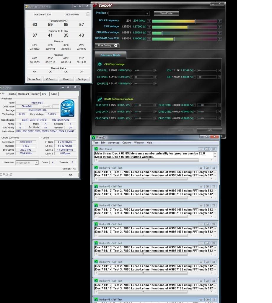

Update
3800Mhz @ 1.20v
200BCLK
1.235v QPi/VTT
http://img87.imageshack.us/img87/9391/3800120vev4.jpg
:up:

I will follow you on this one, my goal was 4.0Ghz 8 cores (4 threads for the WCG 24/7) and 4 Threads for the system. The temperatures reach 90c 8 threads priming but I doubt 8 threads will ever be working at full. So at the end 4 threads 24/7 will be at maximum 77c.
Maybe it is just me, but I notice that I am either rock stable or BSOD. There is no in between where Prime95 is failing or getting glitches. If I can run Prime, then it seems to run forever and everything is good. Just a small tweak, and bang BSOD.
dj883u2, what sort of cooling are you using? Are you on air or water there???
Download the latest Realtemp program and you are going to be very surprised.
