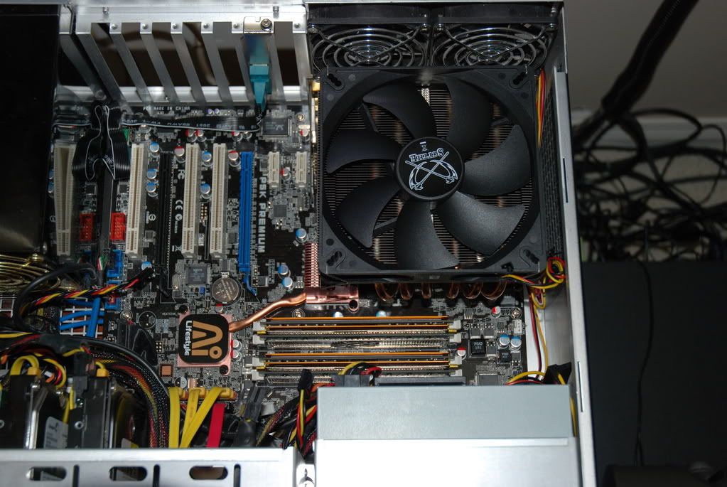

Its just a shame that the nb and vrm`s dont give out temp readings
Nice and very clean setup. I see you chose the HR-05 SLI for the SB, quiet a big investment, but very clean setup I have to agree. I think though that your Reserator is limiting you in temperatures as your circuit is very restrictive too. But I can think you have a very silent setup...

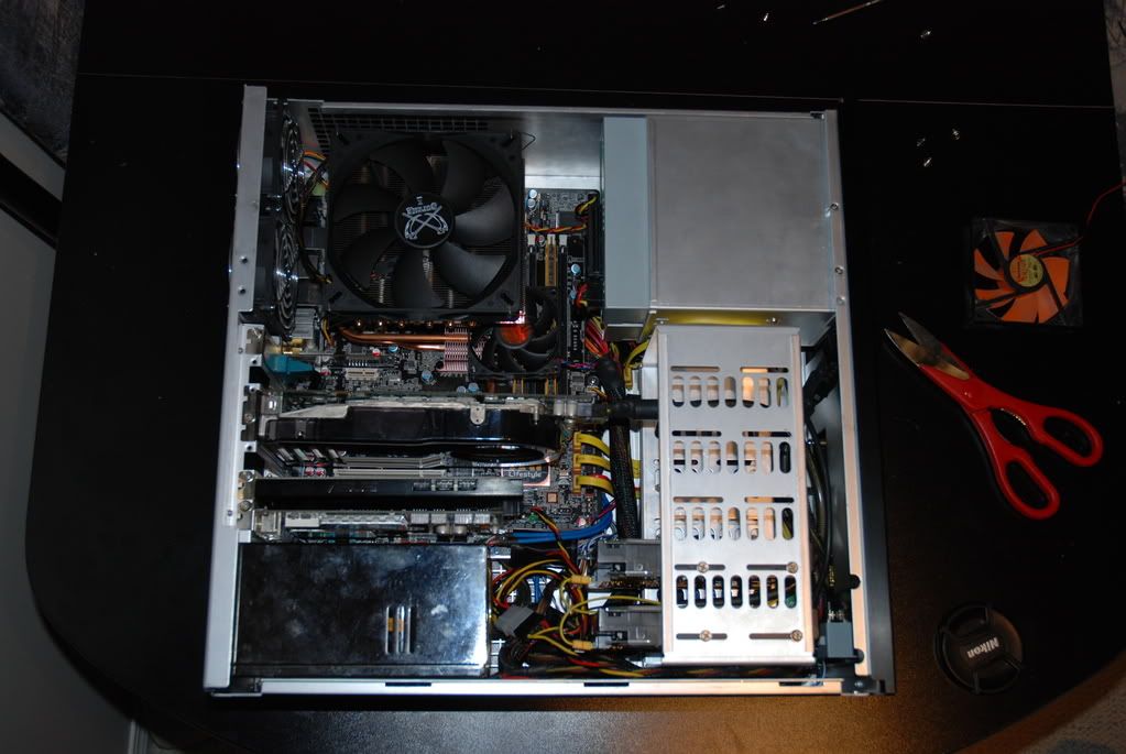

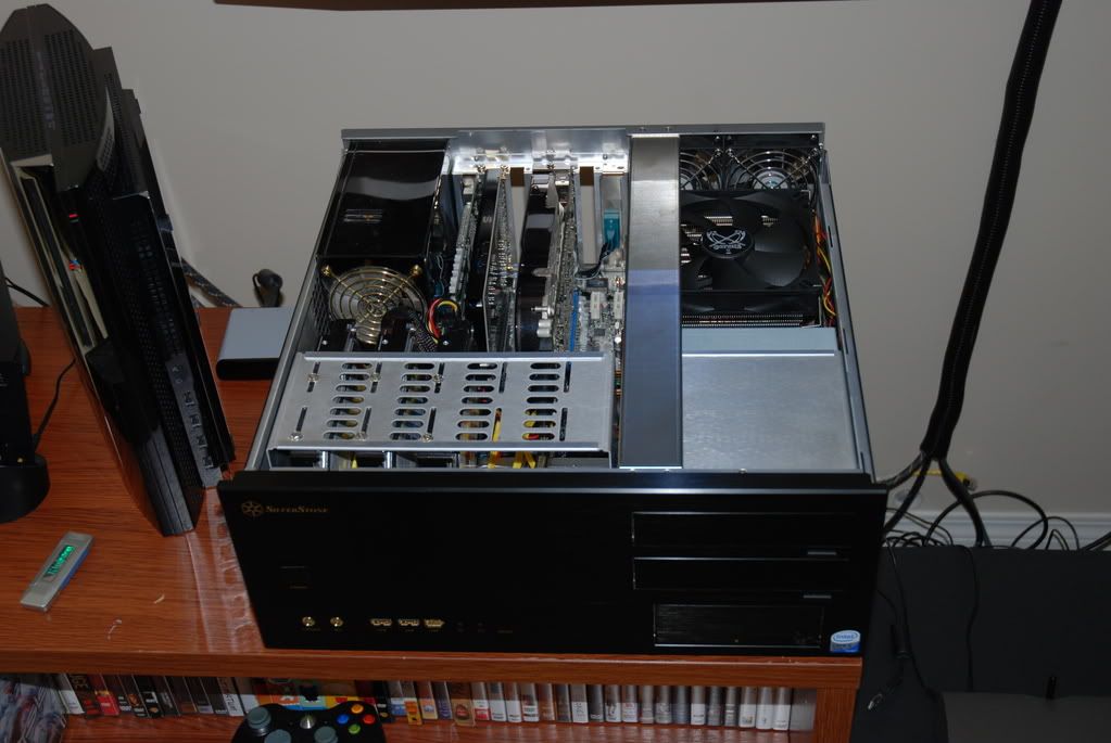

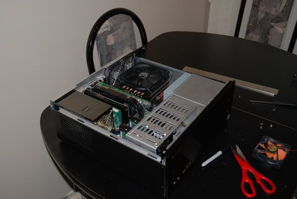

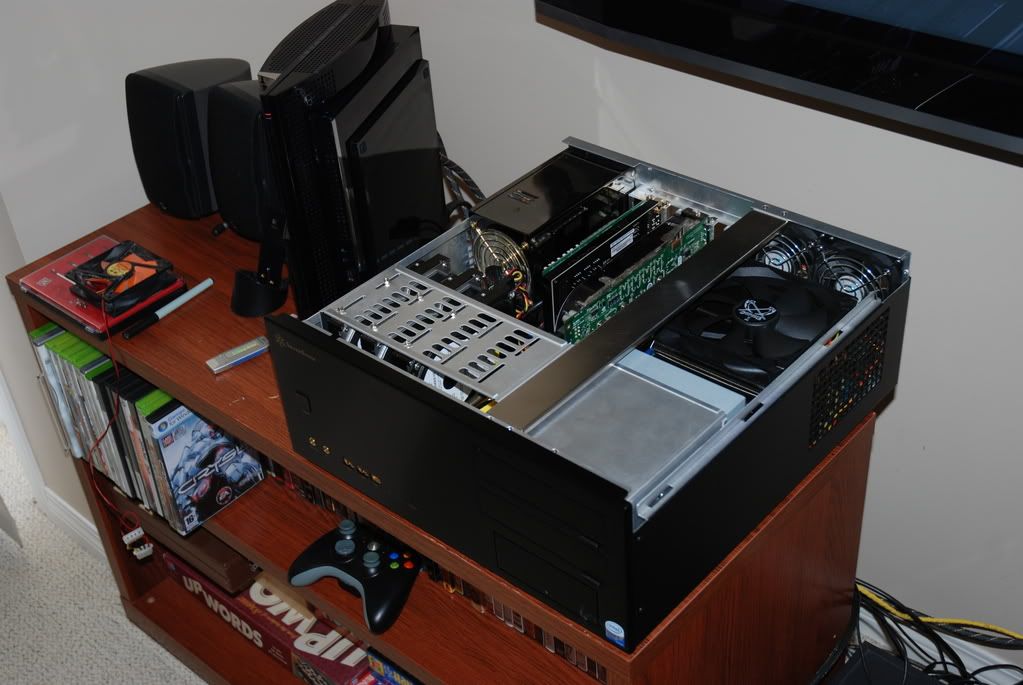

My HTPC is finally complete and running as planned (minus the SuperPI issue)
Specs are in my siggy.
http://img.photobucket.com/albums/v6...DSC_0040-1.jpg
http://img.photobucket.com/albums/v6...DSC_0043-1.jpg
http://img.photobucket.com/albums/v6...x/DSC_0033.jpg
http://img.photobucket.com/albums/v6...DSC_0016-2.jpg
http://img.photobucket.com/albums/v6...x/DSC_0032.jpg
good old AMD64 fan cooling the chipset/ram :D ;)
