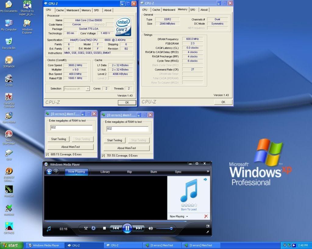

Try Ballistix 8500 again @1200 5-4-4-6 Pass dual Memtest
http://i240.photobucket.com/albums/f...11/5-4-4-1.jpg
http://valid.x86-secret.com/show_oc.php?id=308285
