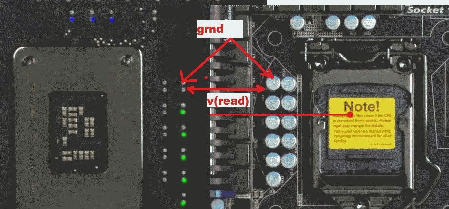

Nice clocks, whats the loaded voltage on that with a DMM ?
1.408v
cpuz shows 1.368v,
DMM is at this point 1.408v? for me is very different, 1.452v cpuz = 1.46v DMM here in terms of offset
you have a large discrepancy
manually set to 1.45v in bios idle cpuz was 1.440v, and 1.416v load
DMM indicated at this point, 1.44v idle and 1.42v load:)
On my UD4 if it shows 1.386 on CPU-Z its usually a tad lower with DMM, but as what Kinzui said at 1.452 cpuz dmm shows 1.46 as well on my board.

http://i1184.photobucket.com/albums/...8/readouts.jpg
There seems to be a +0.010~0.012 difference between the read points that I've indicated with green and blue ( higher read outs on blue ) should I go with the higher read out as my actual voltage?
