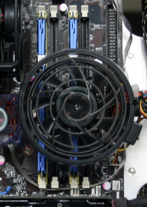

You could just use memory coolers instead. Changing the stock heat spreaders results in void warranty especially if you damage the stickers. Mine runs cool at 1066Mhz 1.9v. I also got an Antec Spot Cool blowing air towards it.
http://i21.photobucket.com/albums/b2...IMG_3394-1.jpg
That looks just like the Antec Spot Cooler I ordered from Performance PC yesterday. Thanks for the reply. Does it help?
Yup it sure does. Even without the Spot Cooler the ram running at 1066 1.9v is already cool. It warms up a bit when playing games or running benchmarks, but with the Spot Cooler cooling it it runs cool most of the time.
