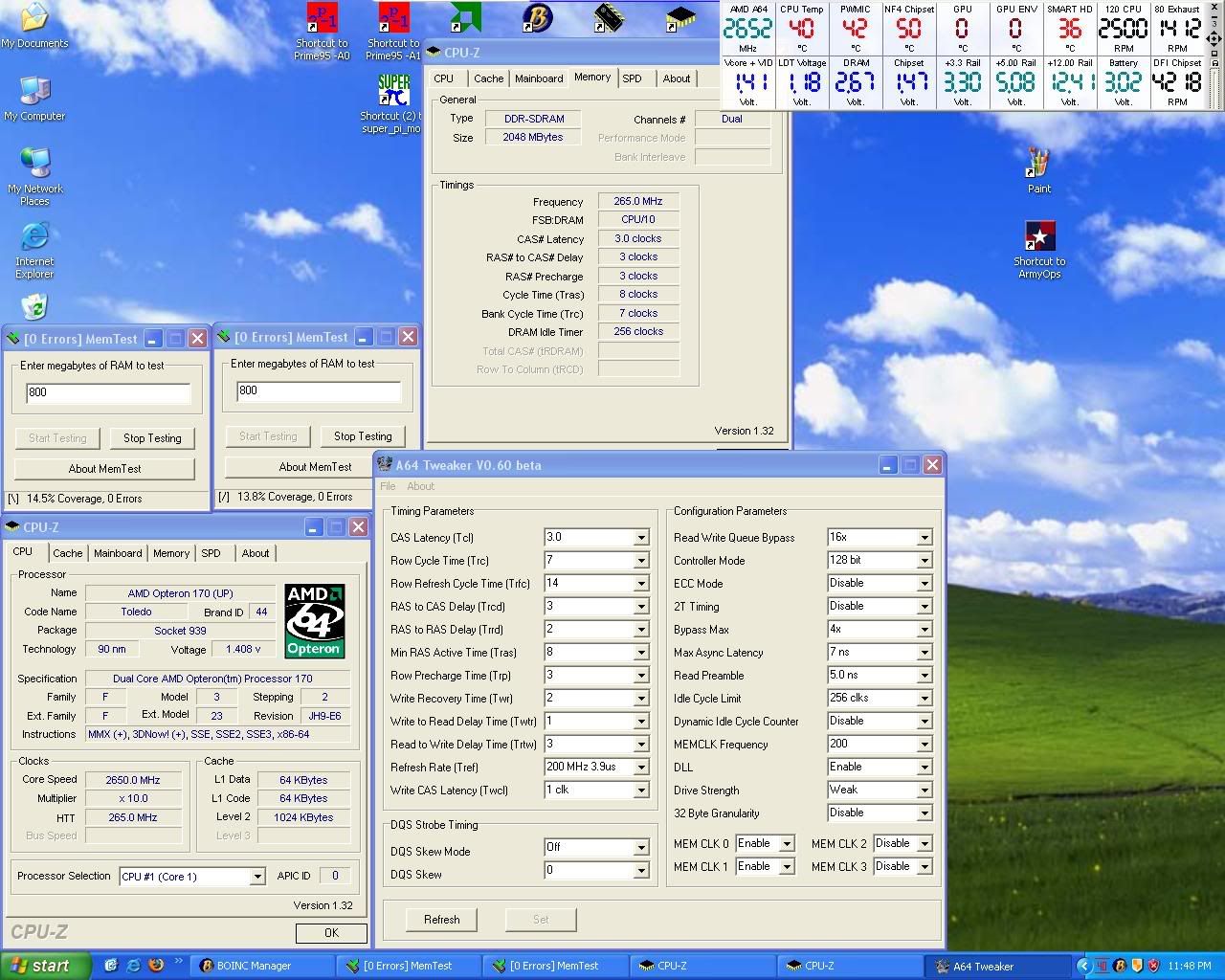

let's say, post your a64 tweaker (most stable results, remember, not my table), then we fix from there;)
K gimme a min right now im running @ 265 so far so good, wayyyy looose
This was taken @ 265 tightened em up a bit
http://img.photobucket.com/albums/v5.../265stable.jpg
this is stable but at 270 no good

I can't seem to get 275 stable for the life of me, I've come a long way from where I was before though, here is my A64Tweak:
http://img55.imageshack.us/img55/7472/2756ni.jpg
Some results:
Loosening MAL and RP to auto/auto/normal made memory 3D stable at 270 and helped stability
Loosening Twr, Twtr, and Trtw didn't did not help stability
Trrd of 3 helps but it is still unstable
Loosening Trfc made memory less stable
Drive Str of 6 helped a lot, I am currently testing @ 5
I am also trying 166 MHz 15.6us as OPB suggested to Philosophy
2.8v helped a LOT with stability
Changing ICL to 256clks didn't seem to help much
I MUST get 275 stable at least, 280 will be icing on the cake
Any suggestions?
