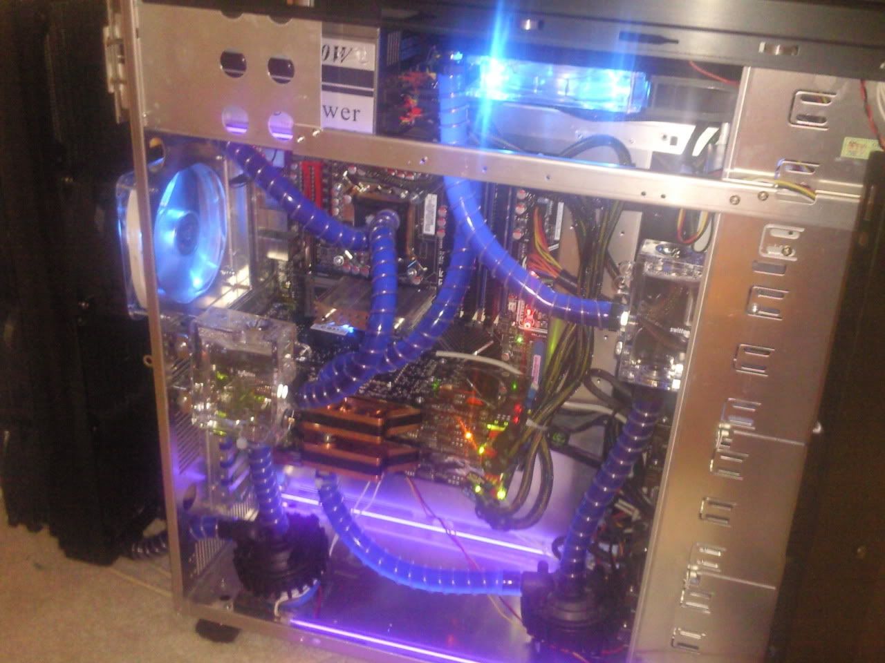

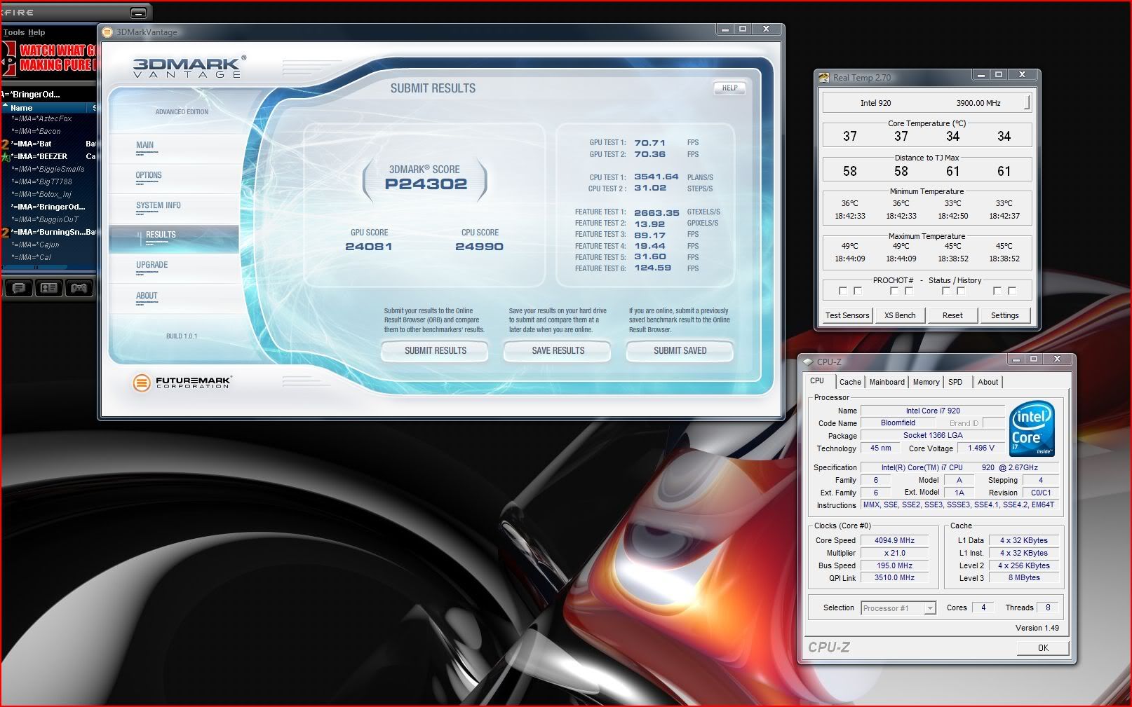

Well, here is my 3dmark vantage score with physx off and quad sli on. This is with 4.1ghz in turbo mode with HT on. I can't go any higher with HT on no matter what voltage.....Scores fine with HT on, I just don't understand why 3dmark06 gives me way lower FPS and scores with HT on....Is there a patch I need to install? Maybe a config I have to mod?? Oh, I also decided to post some picks of my completed I7 rig!:P
http://i246.photobucket.com/albums/g...ma/Capture.jpg
http://i246.photobucket.com/albums/g.../Photo0027.jpg
http://i246.photobucket.com/albums/g.../Photo0039.jpg
http://i246.photobucket.com/albums/g.../Photo0038.jpg
