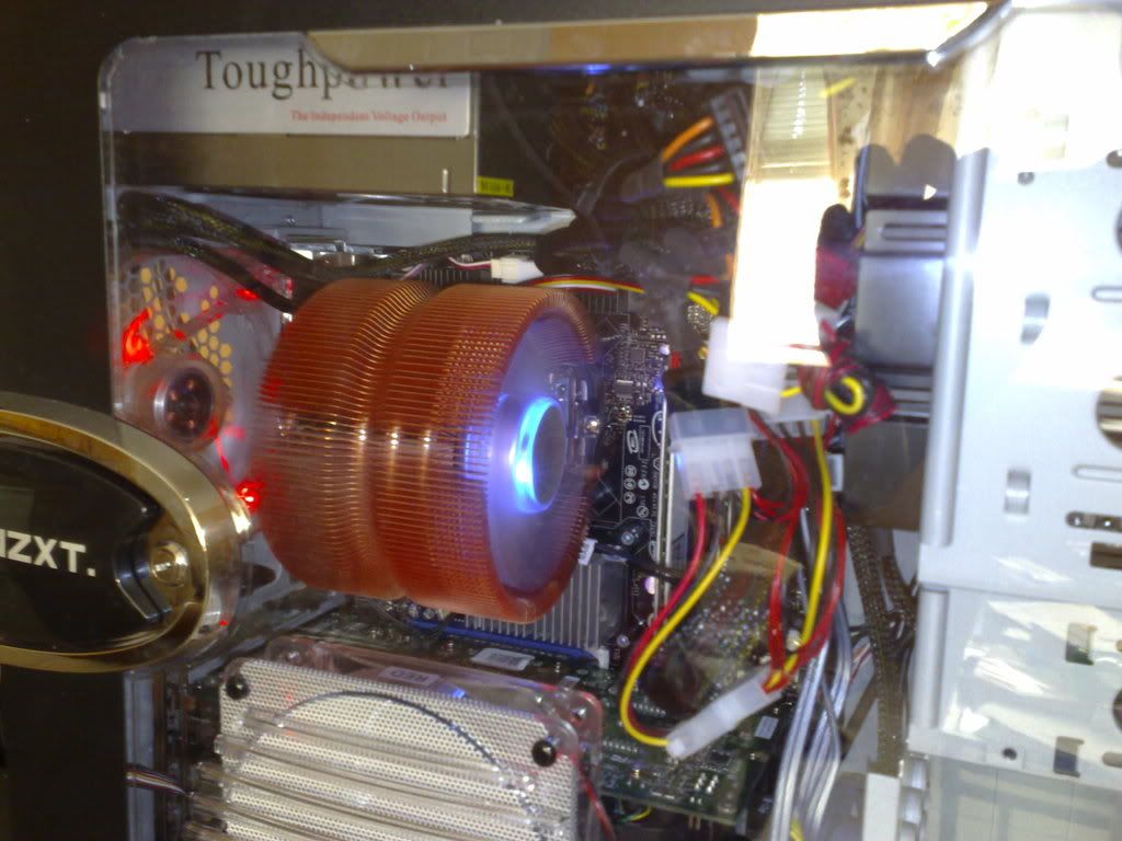

I just build my new computer last friday and I have notice that the temperature reading with Everest Ultimate is too high, is this reading is correct or a bios problem? :confused: But I use Zalman cnps 9700 so I am expecting it to be low temp.:( :( :(

based on your vCore, i'd say you have a Wolfdale CPU. ignore the Core 0 and Core 1 temps; they aren't accurate. just go by the CPU temp, which shows 42°. that doesn't seem too unreasonable to me - not great but not bad either. my actual vCore is 1.25 and my CPU is idling at 40° right now - it's a warm California day. if your ambient is warm, your temp seems about right.
By the way, this is my system. I am planning of oc'ing but the problem was the temp reading. I need your help guys.

Case=hot:yepp: .

as far as your CPU, most people are going to ask if you applied your AS5 correctly and all that. less is more when you're talking about thermal grease. also, that Zalman heatsink you have needs lots of fresh air to work well. does your case have a blowhole fan? if not, you might consider drilling a hole and making one. your wiring is also a little on the sloppy side - clean wires promote better airflow.
that being said, your idle temp is only showing two degrees higher than mine and i have an Antec 900 case, which ventilates very well. i really don't think your temps are bad assuming your ambient is warm like mine.
EDIT: looking at your Everest screenshot again, all your temps are in the 40's or above. you simply have a hot case and probably a pretty warm ambient temp. your CPU temp is as good as it's gonna get unless you turn the air conditioning on.

My case has 3x120mm (1 front, 1 side and 1 back panel), 1x80mm at the top.
I am having a problem arranging my wires, Thermaltake has lots of wire and I am in a hurry to build this coz I don't really have time to make it better coz I am always busy. But I will make it better if I have time, I dont know how coz there is no space at the top area coz Its full of pheriperal(1 DVDRW, 3 Sytrin HDD cooler but only two has hd on it.

I would have to agree with Forsaken, your case is too hot. The case looks like there are way too many wires in it and probably not enough airflow for the small size. A few things to look for, make sure your CPU fan is blowing the air the correct direction, meaning you aren't blowing it into the rear fan. And like was already mentioned too much thermal grease can cause huge problems as well.
