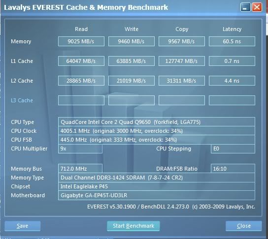

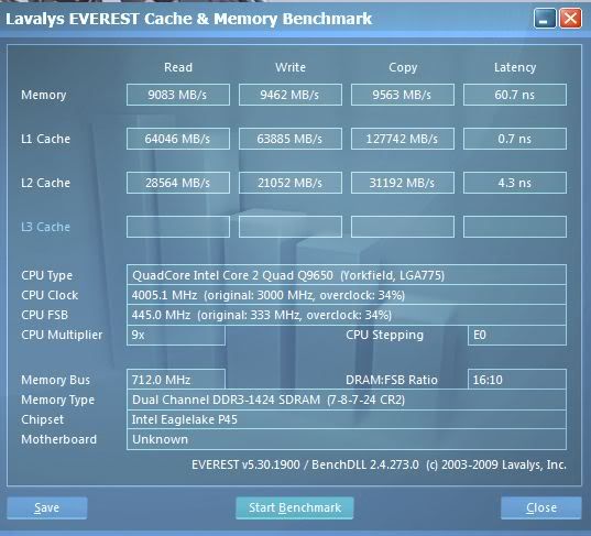

here is an everest shot of my ram setup now , is it any good?http://i651.photobucket.com/albums/u...lall8gig-2.jpg
woops this is with old board i will re run it with this new usb3p board

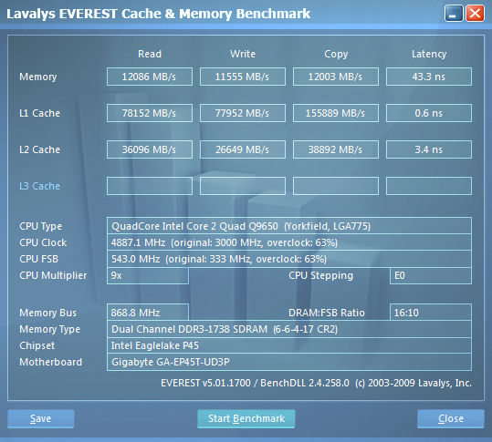

drop your multi to x8 and raise fsb to 500 and you'll be seeing something close to this without raising your vcore:
Edit: Added more screenshots:
333 Divider, 4.00B for DDR3 2000 1T @ 1.66v, 8-9-8-24 (5-6-10-88-6-1) TRD 8
and
7-9-7-24 (5-6-10-88-6-1) TRD 7
I will be doing some more overclocking and testing later...
you think that is the way for me to go to drop cpu multi to 8 and raise fsb.. then if i raise it to 500 that will give me 1600mhz on my ram and thats what i was hopeing for, Am i loseing any performance by dropping the multi to 8? so now i have my timmi9ngs at 7,8,7,24 and sec timmings i set to 5-6-10-88-6-1 like you suggested can I leave those alone and just change the multi to 8? or do i have to loosen the timmings up? , my ultimate o/c i want is 4.0 with 1600 mhz on ram, thats what iam shooting for, let me know what ya think thanx for your help. I realy love these boards I think the problem with the udl3r was it only had a 4 pin cpu power supply and these have the 8 pin wich i think is better than 4 pin ...any truth to that? here is a shot of my ramhttp://i651.photobucket.com/albums/u...newboard40.jpg
Definitely, plus more phases = smoother power delivery to the cpu = better overclocks and less instability.
Yes, leave the memory alone. If your chip/cooling can handle it, you can go for 4.5 (at least for some benches). 9x500 = 4.5GHZ; 8.5x500 = 4.25GHZ (what I'm running); 8x500 = 4GHZ (what your aiming for, and the least difficult to accomplish). I already gave you some tips.
