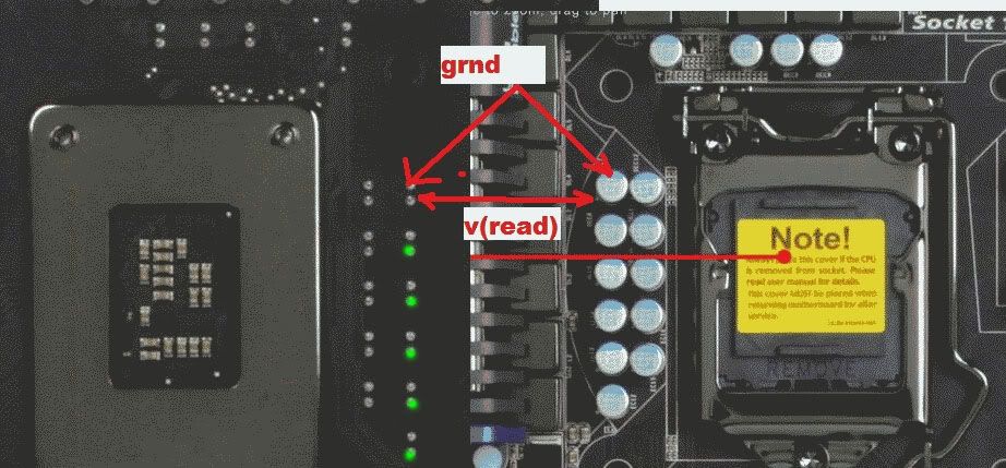

The voltage read out photo you posted on the previous page, is that the only read out pin or any of the 2nd pin on that entire column will work ?
if you're talking about the side of the inductor...yes they're all the same point. im not sure if you can access between inductors...
the lower part i think is for vccsa but you can still measure the voltage from there..just insert your ground probe to psu ground(molex).

http://i1184.photobucket.com/albums/...88/readout.jpg
Just to make sure I got it, all the points I've marked with green can be used for voltage read outs right?
As for the RAM's what app do you recommend I use to test them with, Mem86+ ? How many hours/any specific test to loop? and should i test it at stock 3.4Ghz speeds with XMP profile?
1.yes .....im not sure about the bottom one...just look at the capacitor...the blue marking is grnd...other side is read point..
