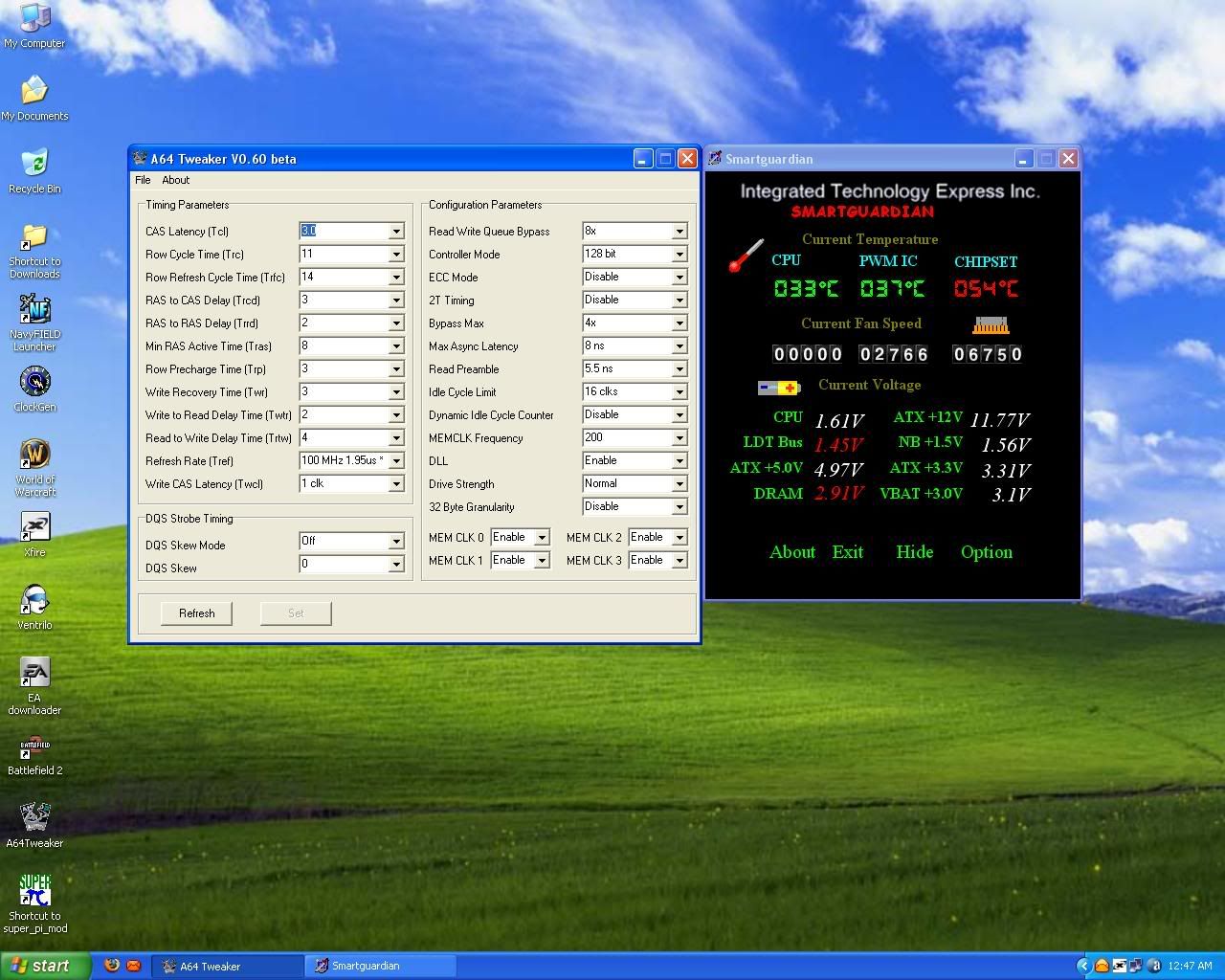

er, raise vcore for 2.9v? unless you normally run in the 1.1-1.2v range, this seems a bit extreme to me. :p:Quote:
Originally Posted by ben805
though.. i guess if you keep it cool, let's hope it holds up. not toooo much higher than jedec specs, though it's also a 95nm ic, so.. :stick:

no, our cronus needed 2.9v to maintain stability at 275~280mhz memclock. As for vcore, normally if mine takes 1.40 to prime stable, I would bump it up to 1.425v or 1.45v, according to BigToe this will help strengthen the memory controller, if you run high vdimm with low vcore you might end up frying the mem controller. Do a search as this topic has been covered countless time!!Quote:

yours is almost identical to mine then :lol: can memtest 280 all night long without any error, but can't spi32m on windows, vdimm higher than 2.92v is pretty much useless as they do not scale any better once they hit the wall. For more stability, try DQS Skew mode: Decrease, DQS skew: 200, ICL: 256, and set both MAL/RP to auto.
yeah, i'm quite aware of this topic, and have participated in it a few times, but i was under the impression that 2.9v isn't gonna do anything to a cpu running at 1.4v.. i mean the voltage difference between vref and vcore is only .05v... ;)Quote:
mikal, try lower data drive :toast:
Is your PSU 3.3v rail greater than 3.35v when loaded?
**BTW, don't pop your LDT and chipset volt that high, just keep the default.;)
When try Venus or Expert, just find the proper DDS for Auto first, but NOT DS for Auto.
when measured with DMM the 3.3v is rock solid and didn't noticed any fluctuation, same as 12v and 5v. Ok...I'll leave the LDT and chipset at default :D :D
My 3.3v rail is at 3.3 on the dime, would you recommend raising it a tad? Perhaps 3.36? Whatever I set it to it will not fluctuate, even +/- .01 :PQuote:
Originally Posted by Onepagebook
So for the expert find the Data Drive Strength first, then Drive Strength? or Leave DDS at Auto and find DS
DDS as auto first then find the DS first
on my situation is set both auto first and get into the windows and see what your ram strength ---->
see normal or weak, then you have better idea what 's the characteristic of your ram,
that would shrink the hassle when you set your DS..
when you have normal, start from 2 on venus,6 on tradition expert and Ultra-D;
phase change also but still wanna try 4 on venus; 8 on expert and Ultra-D
when you have weak, :
Venus start from 1 then 3 (after you try 1 is stable enough)
expert and ultra-D: start as 5 then 7
DO not use memtest in DOS, that just not relible
Always start DS first and fix the other secondary parameters once a time, don't just copy my template.:D, that only for your reference.:toast:
