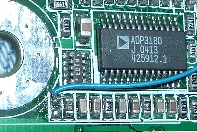

Found an easier way to do the soldered Vcore mod. I'll post pictures of it sometime this weekend. You still have to do the u-wire mod but this Vcore mod should be good for another .15v ontop of the 1.6v the u-wires give you. ;) And there is minimal risk to the 3180 now.
Thats great Jeff:up:,so 1.6vcore is actuel 1.50/55v,so with that mod from you it would be 1.70v,or am i wrong.
If its true my 1.6ghz will do 3.3ghz 24/7 for sure :banana: .
Yeah, I've heard 1.7 to 1.75v is about tops after all is said and done. Personally I'm not going to see because I don't have any kind of cooling except IWTs.
Here's a picture btw...
http://www.adventurevision.com/somep...e-soldered.jpg
It's a blank pad so no risk of knocking a SM component off of hurting a chip. :up:
And the mod is basically putting a 100KOhm VR across this pad and ground. Start off with the VR set to 100K and then work your way down to increase Vcore. Works pretty smooth.

Ok, just did that Vcore mod on one of my PC-DLs and after playing a bit I'm mad at myself... mad because I've never done this mod in the past. ;) It makes it soo much easier to dial in your voltage for stability. I left my u-wire at 1.45v and then bumped it up to 1.51v to get 3.1v(220x14) stable. I'm also playing with some CH-5 I just received so this is actually a little fun. :D

Just be a touch careful with soldering. That pictures makes it look big... but the wire and pad are pretty damn small. :)Quote:
