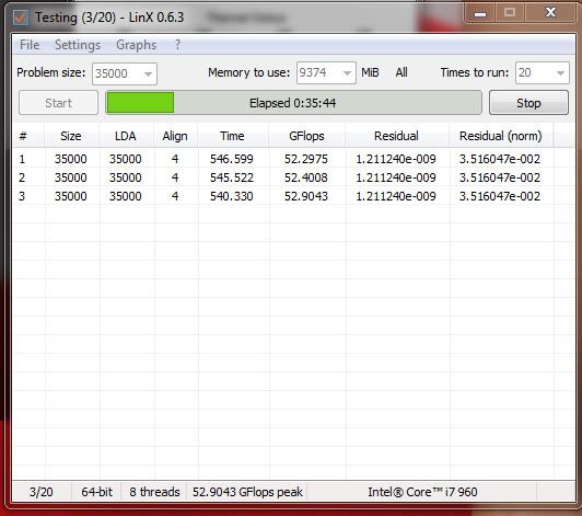

For those of you running < 30000 problem and not being able to pass prime should really consider running a higher problem size.
I can run prime no problem, but when compared to linpack running >30000 prime does not push the system remotely close to Linpack.
http://i184.photobucket.com/albums/x...g?t=1256429105
Well I was running it for half an hour the other day before I noticed it was unstable at that setting (BOINC showed errors after 5 minutes while Linpack displayed none) so it's definitely not working correctly :(

This is just what I needed. Well, bad news then. If it is working, then low temps & GFlops is most likely a Linpack issue. :( LinX seems to do its job just fine here. Maybe play with priorities a bit, or try 32-bit version (just out of curiosity)?Quote:

Yep, sure looks like it. Temps with prime95 at the same time here, way higher.

Having problems running 0.6.4 on my system. I'll start the test, and most of the time my cores are barely being used (looking at a windows gadget showing me the 8 threads). One time I went into the settings, I think I just turned on the Everest monitoring and the sound option, and after that I was able to run a test of 20 passes ok. But I haven't been able to get it to work since. I've tried going into the settings and making some changes to see if that's what made it work the first time, but there wasn't a change.
Never heard of this. I might give it a go.
I hate this «bug» but I still can't find out what's causing it. :( What's worse, it happens really rarely on my PC. I'll keep investigating, but the pattern is still unclear. Any suggestions/observations on low GFlops issue are welcome.

Haha, so I got home, read this thread, decided to try Linx again, and of course, it's working this time without changing anything. :) Nothing with the program anyway., the 2 things I just changed was that I installed the latest beta version of Everest, and to do that, I turned off the %@!$@# UAC. (I don't mind that it's got a job to do, but if I can't even unrar files into a folder in Program Files, then you've become a PITA).
In the IntelBurnTest thread, it mentions doing 16 threads on i7s, is that recommended here also?
So finished one batch, quit the app, reopened, still working. I noticed when it's not working, it doesn't save changes you make to it like the settings, but it does remember the changes when it's working right, so it seems like it can't write to it's config file. I wonder if turning off UAC fixed something?
