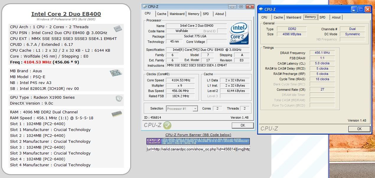

so I just received my replacement board, and it is an A3 rev. Same exact settings as before, at 1.283 and it is stable!!! :)
I'm currently running 456x9 (4.1ghz) at 1.293v, and all is perfect. I guess I'll stick with this.

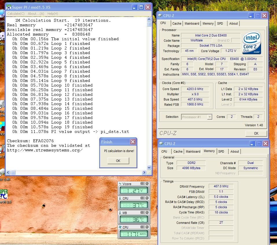

hmm...i dont know man. Mine is now a A3 rev, and it is running really nice...i'm super stable at 4.11ghz (1.29v), will try to go to 4.2ghz on same vcore tonite hopefully:
http://i44.photobucket.com/albums/f3...ghze8400OC.jpg
here it is...currently running 10min and counting of Orthos...so far so good. If it stays stable I'm keeping this!!!
