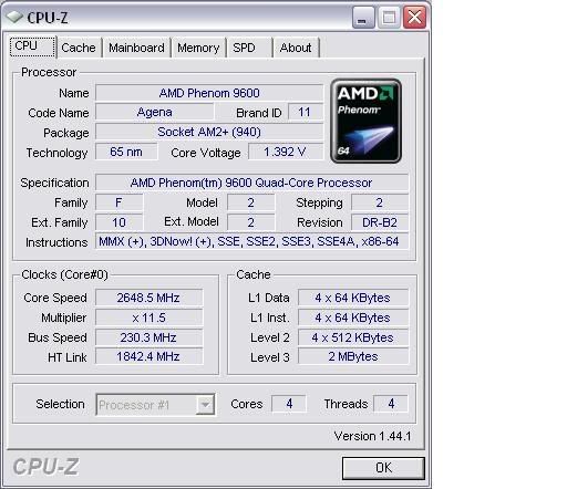

This is a very preliminary result, but it seems like setting the CPU Optimization function to enabled does help stability.. :)
I'm still stuck at around 230ht, but it just seems to run a little smoother/more stable.
http://i30.photobucket.com/albums/c3...5_CPUZ_265.jpg
I do worry a little about the way this board handles CPU v's. My CPU is actually set at 1.325 in bios, and without load it will run close to that, but as you can see it's pushing 1.4 under full load (running Prime 4 core).... I may be a wuss, but I'm not sure I'm comfortable with that. ;)
