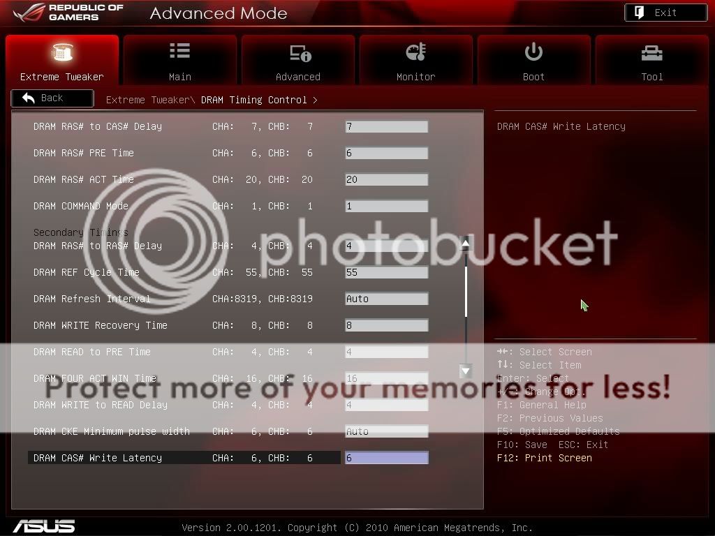

Try these subs, adjusting bit by bit to see if it works for you:
http://i404.photobucket.com/albums/p...vE2133subs.jpg
