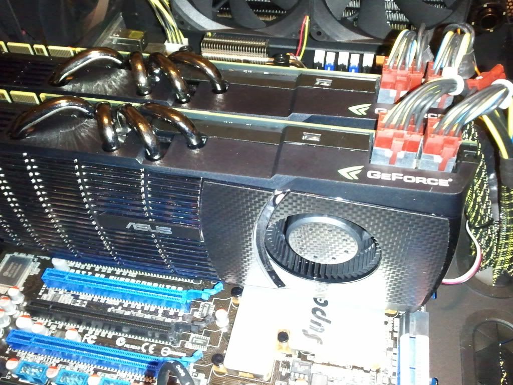

Good news is no melted 24pin socket anymore, bad news is the 1500W PSU wasn't replaced under warranty, I just got what the supplier thought it was worth :(
But this one has been stable for months with a 970@4.2 and 4 x GTX470's@700Mhz so all is good so far. :up:

This is what happends when you put too much load on the motherboard that doesn't have an additional onboard molex connector:
http://img524.imageshack.us/img524/594/dscn1127b.th.jpg
Uploaded with ImageShack.us
http://img25.imageshack.us/img25/7837/dscn1147n.th.jpg
So stay away this motherboard if you intend to build a really powerful system. Or look for a vesion with a molex connector. It is clear now why it was added in the second revision of it. :mad:
Thats only going to affect you if you have three or more beefy gfx cards. e.g. Fermi
