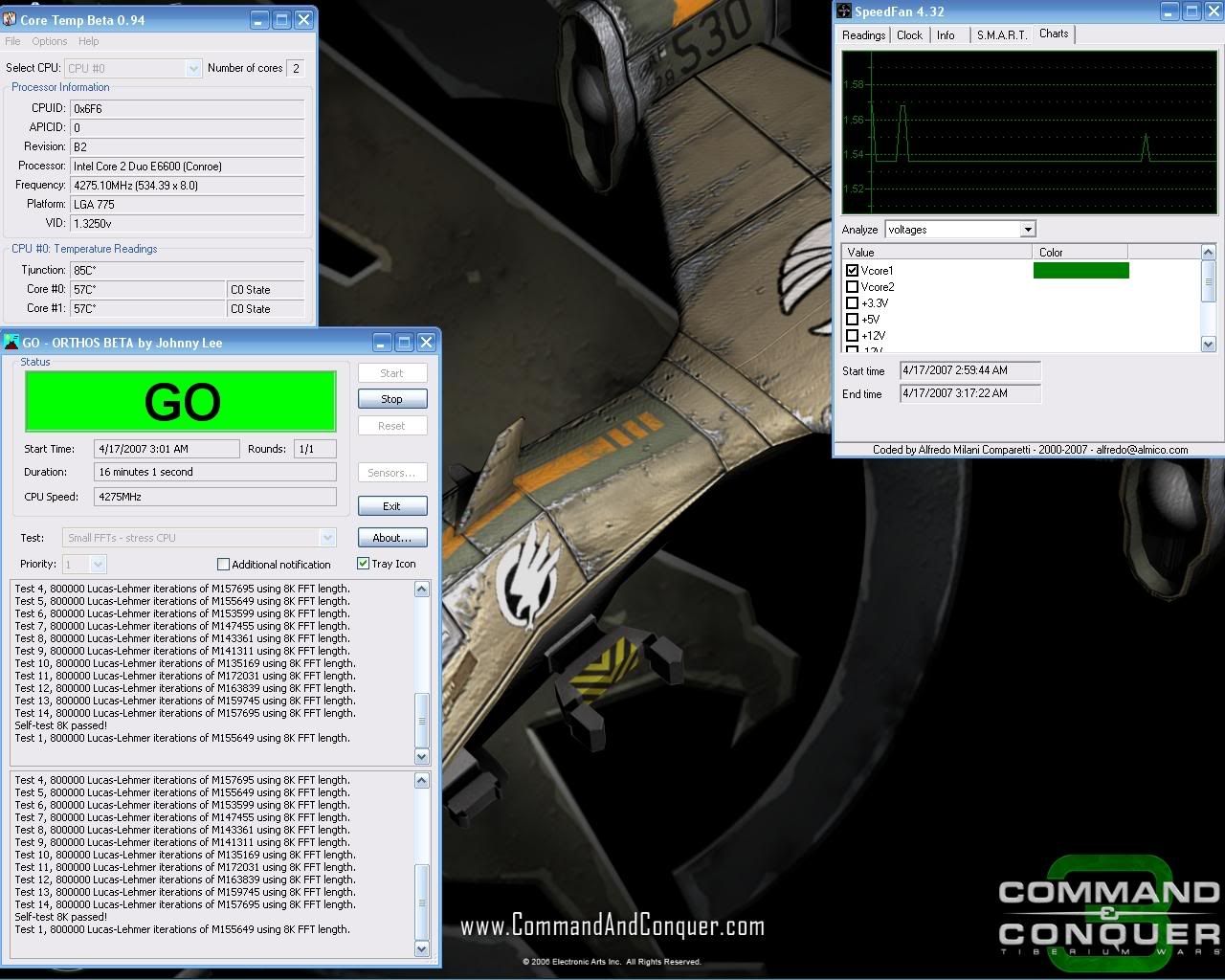

i had more luck ocing on 8x multi than 9x multi
i couldnt boot past 3.7GHz with 9x, but i can do 3.9GHz with 8x, 3.8GHz seem stable for me
http://i121.photobucket.com/albums/o...Shot0037-1.jpg
i did orthos over night and its 5hour stable .. so stable enuff for me i guess
yeah thats with 475fsbx8 (NOT 475fsbx9)
1.65v set in bios .... i dont even how much i get ...
heres one with 1 hour
1.65set in bios ... wow droop .1v
http://i121.photobucket.com/albums/o...2/Shot0042.jpg
if my temps r only 56, 57C small ftt @ 1.65v then hell yeah .. that means i have a good wc setup
