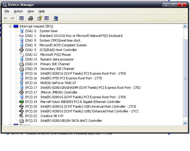

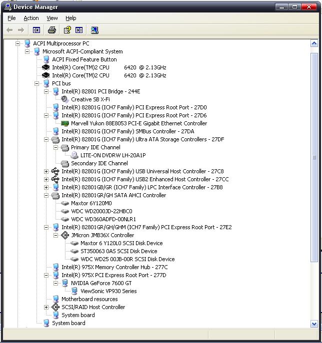

Chrysalis,
"...the soundcard is sharing irq with nothing and is in bottom but 1 slot..."
- not sure from your description, exactly where your audio card is installed, "bottom" vs., "Slot 1"
- P5WDH manual, page 2-23, PCI slot 1 is in the middle, closest to PCIE x16 slot
- "bottom," assuming the edge of the board, is Slot3, which is shared with ICH7 SATA controller
- my normal practice when installing new MB's is to map IRQ assignments and install cards appropriately
- lots of opinions about modern OS's assigning/sharing IRQs vs., MB assignments
- attached "IRQ" and "Device by Connection," XP Pro SP2, as sample references (JMicron enabled for clarity)

ADDITIONAL INFO:
- from notes at install time, Nov 2006:
Intel 82801GR/GH SATA AHCI Controller (P5WDH)
- IDE Primary
- Port0 SATA 1 (red) (LOC 0)
- Port1 (to SI4723 controller) (LOC 1)
- Port2 SATA 3 (black) (LOC 2)
- Port3 SATA 4 (black) (LOC 3)
Silicon Image SI4723
- EZ_RAID 1 (orange)
- EZ_RAID 2 (opange)
JMicron JMB383 (ICH7 PCI Express Port 27E0)
- EPATA IDE
- SATA RAID1
- External SATA Port
IRQ SHARED - (Page 2-23 of manual)
PCI1 - shared with 1394 FireWire <-- (where my Creative is installed, firewire disabled in BIOS)
PCI2 - shared with ICH7 IDE Controller
PCI3 - shared with ICH7 SATA Controller (edge of board)
Onboard IDE (JMicron) - shared with USB Controller 2
Onboard LAN1 - shared with USB Controller 4 and HD Audio
Onboard LAN2 - shared with PCIE x16 and one PCIE x1 slots
PCIE x1 - shared with USB Controller 4
USB 2.0 Controller - shared with USB Controller 1

Ok sorry for the confusion from what you said my xi fi will be in pci 2 and according to the manual is sharing with ide but it isnt using irq 14 or irq 15. I also only have the dvd burner on the intel pata interface I use jmicron pata for pata hds.
I will move it to pci 1 as that seems the best port to use I agree with you there and I am now glad I couldnt manage to use pci3 as that would have been the worst slow. Strange how they still cant give each pci slot its own irq assignment still.
The question is tho as the bios assigns irqs on a apm/acpi basis ie. only up to irq 15, is the irq still been shared when windows APIC kicks in and irqs above 15 are been used?
see below
http://www.chrysalisnet.org/irqs.jpg
http://www.chrysalisnet.org/connection.jpg
Chrysalis,
"...The question is tho as the bios assigns irqs on a apm/acpi basis ie. only up to irq 15, is the irq still been shared when windows APIC kicks in and irqs above 15 are been used?..."
yes and no, and to make sense of why this is, some links below:

The xifi is now in pci slot 1 the one near pci-e port, the stuttering seems to be significantly improved so although device manager says there was no irq conflict it appears there was, I think now the drive which still has some stuttering is on the jmicron pata controller so will move that to be slave to my burner on the ich7 pata to see if better or not.
I still am unable to toggle write cache on the ich7 although I want it disabled (have now disabled on all the jmicron drives) I think the fact it cant be toggled still seems to indicate a problem, using dskcache.exe a command line tool from microsooft confirms write cache is disabled but when trying to enable using the tool it is refused so is greyed out because the functionaility isnt available. I noticed in raid setups intels matrix tool allows it to be enabled but doesnt on AHCI non raid setups.
XP reinstall still not done this is because of me moving the xifi card.
to bichi, yeah I did try toggling that option in the bios but the irq assignments stayed the same I guess it makes no difference unless reinstalling the os, incidently my listed irq for the xifi is no 21 not 22.
