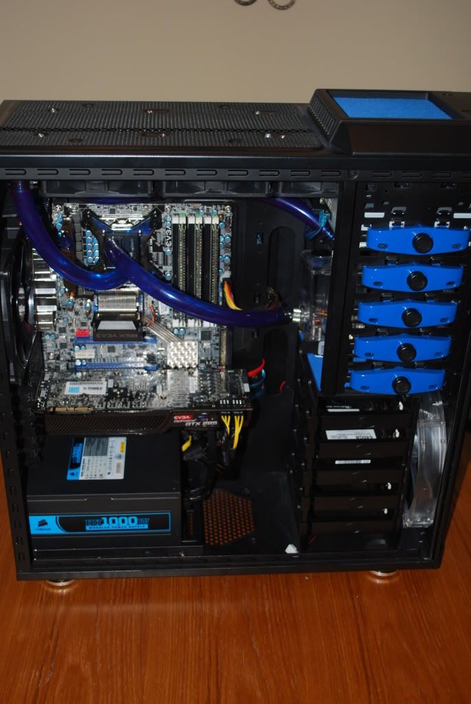

heres a clearer shot of the case. you can see where the psu and hdd's are hiding lol!

Has anyone managed to get 1 triple and 2 double rads inside a HAF? I'd love to fix mine so it did, but it's hard to picture if it's even possible without removing everything :P
with imagination everything is possible freonor;)
looks like you could cut a big hole in the side panel and mount them there over the motherboard
having rads in the sidepanel sucks though :S Difficult to handle when I have to open my computer. Which I need to quite often :S

I saw, in a thread somewhere, some triple radiaters that fit in the top without drilling holes. I think Swiftech's was one. Can anybody confirm this and maybe know of others? Also, I can't seem to find a res that will let me make use of the fill port. Looks like most, if not all, bay resevoirs will block the port. I'm not sure what to do here. I could do as myowngod did. Or mount the pump/res in front of the PSU. I would really like for the res to be the highest unit in my loop. The best looking solution I have seen is the Typhoon res/D5 combo but that would eliminate the use of the fill port. Oh. and this is definately the most expensive set up I've come across. Maybe I should just forget the fillport. I just seem a waste to not be able to use such a cool feature. I have no idea how to tap holes in plastic (don't remember what resevoirs are made of at this moment) as that would solve my problem. Any ideas.
I just got the idea to wc when putting this case together. It will be my first loop.
I've come up with the idea of getting a bay resevoir and making a new hole in it. I can get some scrap pieces of plexiglass at the hardware store. New project - learn how to drill and tap plexiglass. Or, drill a hole and find a suitable plug.

This is what I was doing. I got this far and decided that its time to try w/c.
http://www.xtremesystems.org/forums/...&pictureid=622
I have Ultimate radiator combo from Petra's and D5/655 vario pump on the way. Trying to get a Typhoon III reservoir. I wish it had a fill port under the case's. I'm practicing drilling and tapping plexiglass to see if I can do a clean enough job of it.
Looking at myowngod's I kind of wish I just got a 355 with xspc top and mounted it in front of the PSU. I think, that way, I would have been able to pull it out and raise it above the rad for easier bleeding. Nice buil bye the way.
