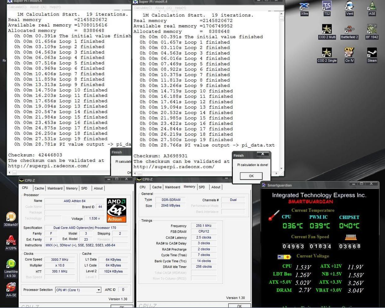

hi am new here as u can tell just wanted to pst my results
what program u use to reduce the screenshoots
am runnig my opteron 165 @2998mhz @1,38v i vould like to show u am in iceland

still very nice my 170 0546XPMW needs 1.536v to hit 2853mhz dual prime heh
wow, thats amazing, are those volt readings accurate or are they like cpu-z .02 under?Quote:
Originally Posted by Rufus7
have u found a max yet?
So you couldnt do that before? Maybe its time i get another psu :(Quote:
Originally Posted by eva2000
nope before max dual prime was 2800-2850mhz at 1.6v and max benchable 2900-2950mhz
now 2853mhz at 1.536v and 2900mhz at 1.6v dual prime so i'm hoping i can get 2950-3000mhz benchable :)
