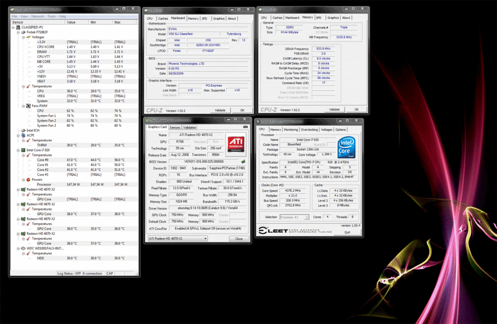

owikh84| Core i7 920 [4C 4T] @ 4545.7MHz | 1.388 | EVGA Classified E760 | Water | 3914A113
i7 920 D0 @ 4.557Ghz (217x21), uncore 4340Mhz
EVGA X58 3X SLI Classified E760
Corsair Dominator GT CMG6GX3M3A2000C7 6GB @ 2170Mhz 8-8-8-24-1T
http://img816.imageshack.us/img816/7995/4545.jpg
ambient: 35C Penang, Malaysia
I'm 25 run+ stable at this speed I just want to show off the everest vs eleet info.
Has anyone tested the Beta BIOS 70?
just noticed.. nice clocks but looks like bugged to me.
owikh do u mind redoing ure 217
cause its looked like faked with the eleet bug
that when u raise the pll software it slows down ure proc

I bet you guys know EVGA E-LETT good, but it is new to me and I have couple of question
How do you start multiple instance of it?
How accurate is the readings in Monitoring tab, the Vcore, VVT, DRAM etc.. ?
Does that OCing thing works?
I'm using it on a SR-2 tho, but it should be almost the same.
Why do you need multiple instances of it?
Just start multiple times CPUz I think eleet cant be started many times from 1 account. As to the voltage reading its the same like every other software(everest etc..). Just measure ur voltages with DMM and dont look at this. Its showing me VTT = 1.5v, I`m using VTT = 1.4v. DRAM its showing 1.72 and this is correct I have to say 1.65 set at BIOS but classified is overvolting so the real one is 1.72 measured but NB Core is 1.15 it`s showing 1.18. OC works good np I still cant make setfsb to work with classified and the only software I`m using for OC in Windows is eleet.
It shows temp for just 1 CPU at a time, an I have to select/switch to see the temp for each CPU.
Yes, I can open several CPU-z, but not E-LEET.
I'm wondering how accurate these E-LETT readings are compared to your DMM-readings? Specially the DRAM and VVT?
Yeah, SW-reading is not the best, but that's all I got for now. The DRAM is overshooting on SR2 too, the 1.61v BIOS-set ends up as 1.65v in W7, But the VVT is really weird, , it is increasing on CPU#1, 1.325v BIOS-set ends up as 1.33V in W7, but is decreasing on CPU#2 from 1.375v BIOS-set to 1.35v (all according to E-LEET). These variations are OK, as long as they are not too off from DMM-readings, then we can adjust accordingly, but I don't know how off from DMM-readings they really are on SR-2 .
I'm using that too, but it is reporting ~3-4'C less at idle, and 4-5'C more at load compared to E-LEET. Reltemp is showing only 6-core and reporting different temp too. The temps av individual cores is not the same between these 3 either.
I guess the X56xx ES doesn't got the most accurate sensors, but I'm trying to get an idea of real load-temp, and have to switch E_LEET all the time, and it doesn't make this confusion any simpler. It is OK, I can live with that for now.
Why don't you use everest? it has support for the SR-2
