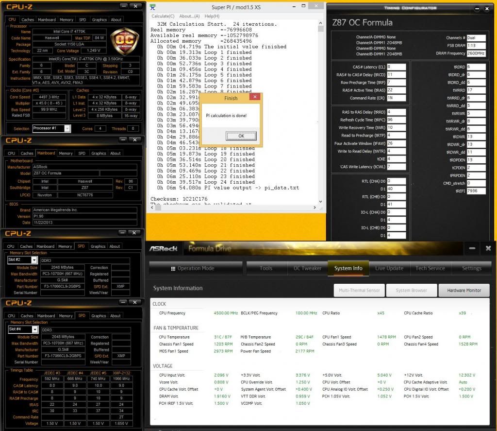

I finally managed 1300MHz 8-11-7-28-1T out of some of my BBSE, the Perfect Storm 2133C9 to be exact. I used some of the IOD/IOA/SA volts from the Z87 OC Formula thread and found settings that worked, and the board trained with high VDIMM no problem this time.
http://i947.photobucket.com/albums/a...ps31246b86.jpg
Now if I could only find a way to get some of my PSC to do 2666 8-12-8-28-1T and pass :(
