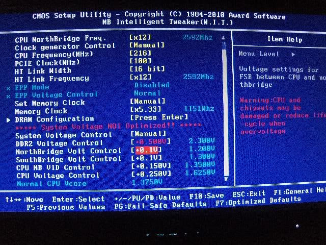

Theres so many factors involved as we venture to install unlocked chips . This alone is a 50/50 chance the Mobo and Chip is up to it. If the CPU unlocks and the NB dosnt go above 2600mhz with 1.3v on the NBvid , It most likely is a weak CPU IMC.. If one has a spare DDR3 mobo, that unlocks ,, you would then test that same CHip again.. If it unlocks and is 100% stable you have a weak Mobo or DDR2 IMC but the DDR3 IMC would remain strong.

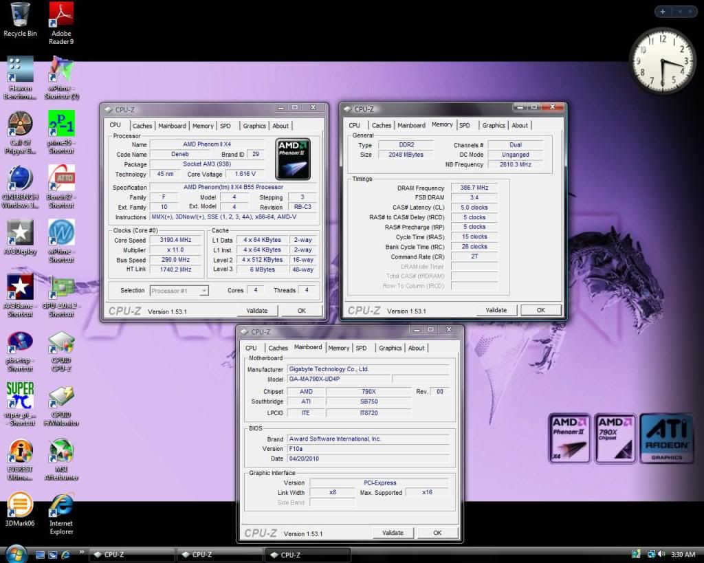

If you Try X4 Air/Watter @4300mhz @300HTT... Its not so easy( at least what ive seen)..The extra CPU load and use of Onboard SB750(Sata Raid 0) makes it a little Harder.
I keep my HTT down around 220 or so for 24/7 on this Mobo for reliability reasons. I know its not the best Clocker and some Mobo's will die real fast when pushed up to much.
