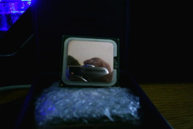

Not even close to as shiny as most in this thread but I thought I'd share my first one.
http://boxcarsolutions.com/misc/lap2.jpg
http://boxcarsolutions.com/misc/lap5.jpg

And you get a shiny looking chip to reflect off ordinary household objects and share in a forum on the interwebs! My favorite's the one out the window a few pages back.
As long as it's flat, right? :D

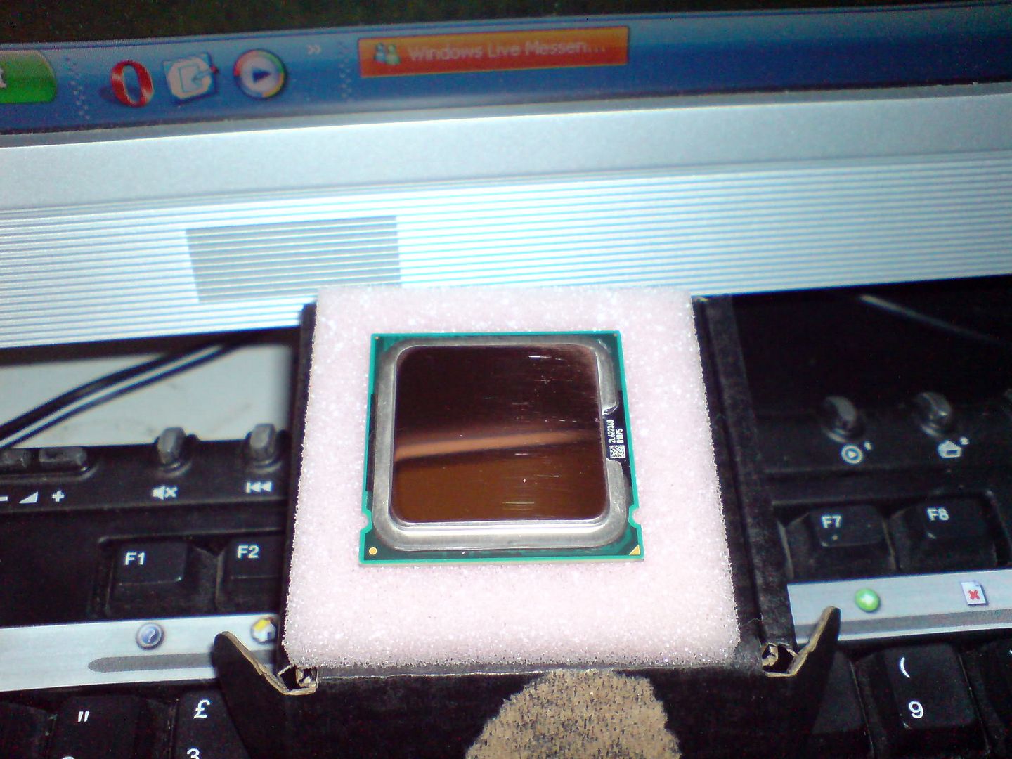

Here's my very first attemp done ( dry ) not bad if a say so myself all by hand no polishing tools lol.
http://img406.imageshack.us/img406/4...elapps9.th.jpg
