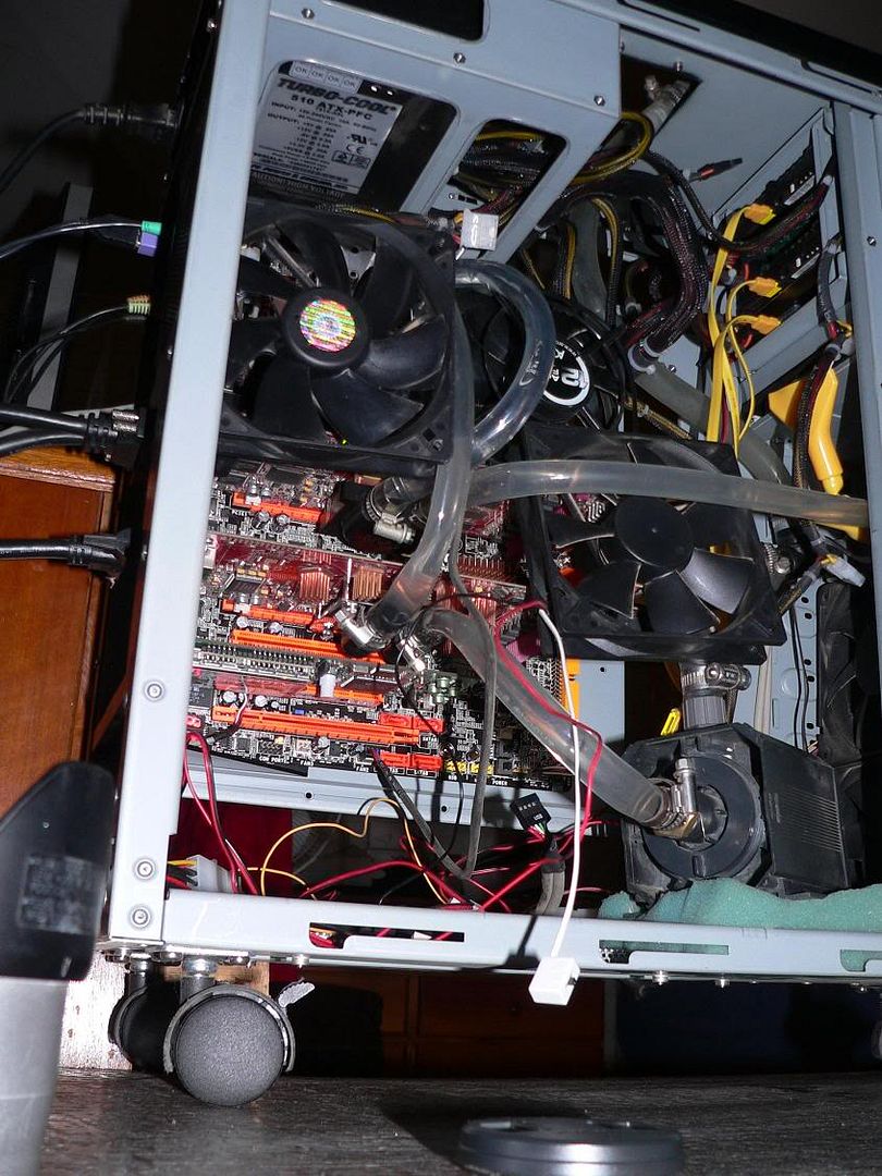

It was on air, lots and lots of air. CM Stacker case, replaced the four 120mm fans on the door with high speed units and hung two others over the CPU area. Not something you would want to do for very long. ;) Also, pushed the volts on the board way up and the CPU was at 1.575V. My E6600 is not that good so I had to zap it. :DQuote:

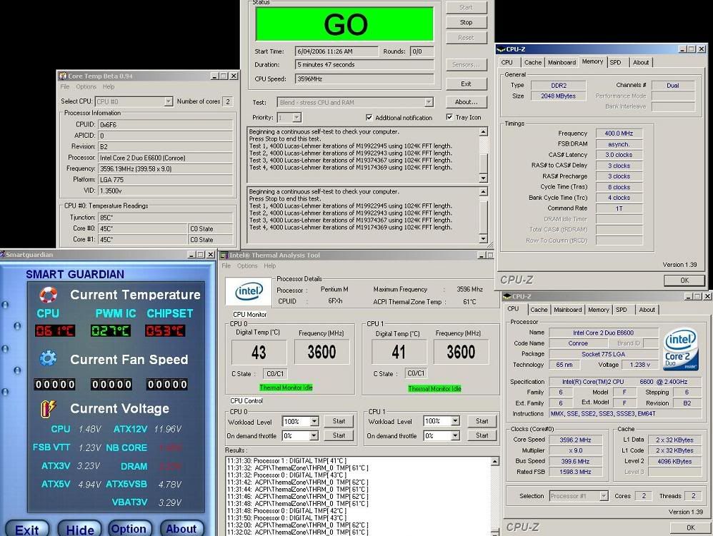

1) Just so you know.
FSB CPU 511 max thru bios
MEM FSB 658 Thru bios, so 1316 max DDR2
2) Droop
Idle 1.596
load 1.590
under nature 3d01, Orthos is crashing the board here. (feels like a code issue) All 3d at this time has been fine.
3) guys apps can have code issues with chipsets, we saw the same with early builds of memtest86 and prime had issues with Athlons also.....so it just may need a tweak or two to run 100% on this ATI chipset. Then again it may be just plain unstable...I will try to run some tests to see soon. (ORTHOS versus application stability talking)
4) There are not any memory dividers on the RD600 per say. The memory clock is true async if you want it be. I can set DDR2-1103 with a 283FSB or DDR2-981 if I want as an example. The memory clock is totally independent of the CPU FSB in async mode and it works very well.
5) Guys some more info for you;
RD600 is not as fast as i975 for superPI, if this matters to you and you spend all your life watching the PC crunch 20 loops then this is not the board for you.
RD600 is FAST in 3d though, and I hear with a hacked SLI driver its faster than i680 in SLI with 7900's.
So PI freaks may be disappointed, 3D benchers may be thrilled....you just need to decide what’s for you.
6) Ram performance @ 550 and 571: http://www.xtremesystems.org/forums/...&postcount=456
7) Sata performance: http://www.xtremesystems.org/forums/...&postcount=474
8) small summary:
a) 511 FSB at least 4 hours orthos stable (blend)
b) SLI hacked drivers work
c) Faster in 3D than 680i
d) memory clock is true async
e) up to 1.94 Vcore available
f) vdroop of .006 @ load seen thus far
