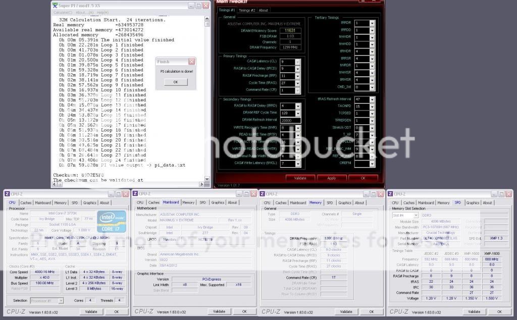

Hey guys , it seems that 16FKR is not so bad at all:D
i have here 2 kit?s dual crucial-16fkr, today i decided it must one more time tested before sell them on ebay.
2 modules cant boot 2400 , one can boot 2600 9-9-11-27 with 1.950v but cant pass32m , and one is crazy ..2600 9-9-11-27 , third secondary and tertiary timmings, with only 1.880v...this stick its very hot , ambient was 28degrease..
so , if you buy dual channel kit ..need tested each of them separately.. it?s time to binning micron:D
