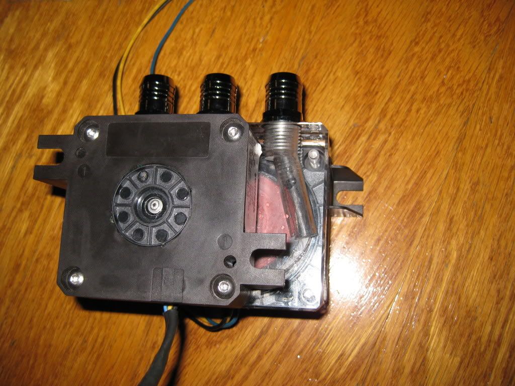

and to my last knowledge, it wasnt the black impeller DDC-1 which were the best, it was the RED Impeller 18W DDC-2:
http://i125.photobucket.com/albums/p...s/IMG_0082.jpg
Interesting to know that the ebay ad states,
"...This is the rare special edition Laing DDC1A-VC with built in liquid volume compensator. It is the famous black rotor version with bigger center inlet hole. These pumps were originally pulled from working Mac G5 liquid cooling assemblies. The liquid volume compensator is a deluxe feature of Laing DDC water pump for OEM order only and it is not available for sell in the retail market until now. ..." http://cgi.ebay.com/Laing-DDC-water-...item35af2f581c
The DDC1A-VC 12W for the Apple G5 workstation used a corrosive salt based coolant. Since these were pulls from actual G5 machines, I would not even dare get involved with those pumps. There are reports all over several of the Apple forums about this coolant leaking and ruining hardware. :down:
Now, when the Dell H2C 720 gaming rig came out, Dell did not want the to replay warranty issues Apple had with those VC pumps. Instead, they went with a distilled water and propylene glycol mixture with a custom corrosion inhibitor package. :up:
