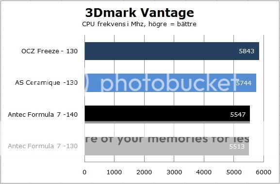

Testing with higher mounting pressure would of course yield better results, however I've repeated these tests atleast twice with same results. It will still show how much of an insulator the different TIMs becomes at these temps. The spike is not because of some tilt, I've seen this many times when benching (at a certain temp the benchmark crashes and you can't run the same frequencies again). For next round I'll try to make some proper mounting.
Very interesting points, as I said more perfect results can be achieved but from my real world experiences these numbers match very well.

did some testing too..
http://i536.photobucket.com/albums/f.../LN2test-1.jpg
as you can see, with Formula7 i was able to test at -140 (CB at -149), while with OCZ Freeze, the CPU coldbugs at -133..
in my oppinion clear evidance of bad heat transfer of the thermalpaste..
