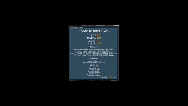

yea the tri sli 470 numbers seem a bit odd, but here's my score.
Here is mine........

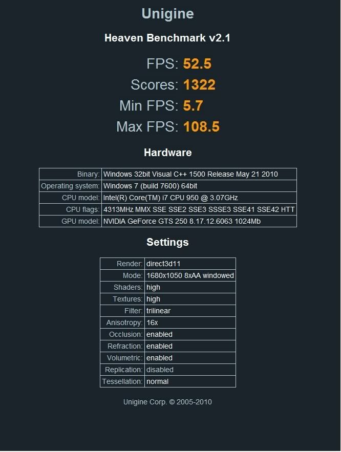

Not bad!
here's mine guys!
