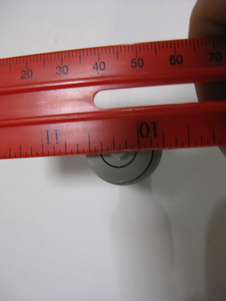

As i said you can get a very large inner chamber version, only problems is its not threaded, and as i said it looks uber ugly:
http://i125.photobucket.com/albums/p...a/IMG_1321.jpg
http://i125.photobucket.com/albums/p...a/IMG_1322.jpg
http://i125.photobucket.com/albums/p...a/IMG_1323.jpg
so who has got VL4's??

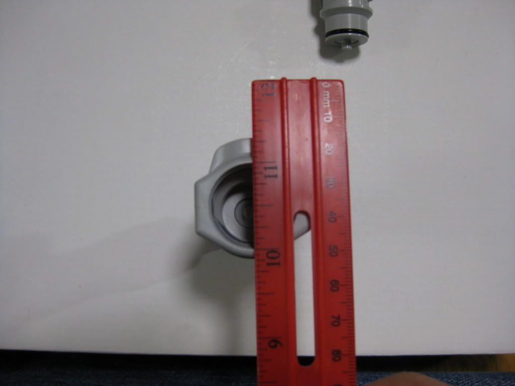

I've got one set of VL4's. Would have two sets, if P-PC's didn't screw my order up and send me two more females. :shakes: They're freakin' beasts. Like a big roll of nickels, and almost the same weight. Here's a side-by-side with a BP 1/2" fitting. :D
Edit: About 8.5cm long, when coupled like that. Although you need a couple extra cm to make room for them to be pulled apart.

That is BIG! What is the overall length of that Q/D?
