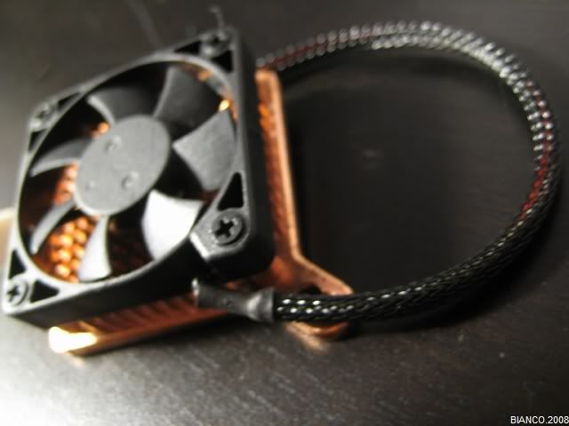

oh regarding the aircooling solution..i was having this idea..picture from bianco..:)

but 780i has two ends to cool..so i was thinking of using that fan to cool my cut up sb hs..hardly pretty..but thats what a desperate man would do..lol..
another idea was using the thermalright coolers..but u gonna figure out a way to conduct the heat from the other end to ur hs..>.<
hah..i think thats why i was so motivated to mod the current ek waterblocks instead..(ar..there i go again..i meant to say get someone to mod my current ek waterblocks instead..) on a side note..i can hardly overclock my processor to my usual 4.4ghz at that time..i figure it must have been the southbridge..

Ahh so I guess cutting up the original heatsink would be okay and reapplying it with some paste and a fan be sufficient. Once I get the nod from you that it works I'll probably start looking at my water setup.
i prefer you not to cut the heatsink..hah..
i am nt sure if it will be sufficient for the cooling..adding the fan on the hs..coz i myself never had the chance to try that..but from wat i had gathered..southbridge doesnt realli give out so much heat..and throughout my overclocking from 3ghz to 4.6ghz..the voltage for southbridge remains the same at 1.5v..
actualli since u gonna watercool ur mb..might as well try to find ways to wc ur sb..maybe u can try bugging bitspower to do a nb + sb for striker 2 formula..coz they already have one for ref 780i..
sigh..sb cooling been a prob for striker 2 users..sry i cant help much..

Also, to you and gatecraherlok I am using the Striker II Formula and I have a mips SB block that should fit in a triple SLI set up (might struggle if your middle card uses a back plate), have a look below (my Mobo)-
http://i375.photobucket.com/albums/o...hwee/Mobo1.jpg
Man i've long'd to dump mine under water for so long and a year has passed with no real solution. It definately will not work now that I have upgraded the graphics car dto the 295. inspecting your picture the graphics card will not fit into slot one. Looks like I have to wait a little longer then to see if anything else crops up. If nothing comes before april, I think I'll close the doors on this coffin and go x58. I've waited too long.
