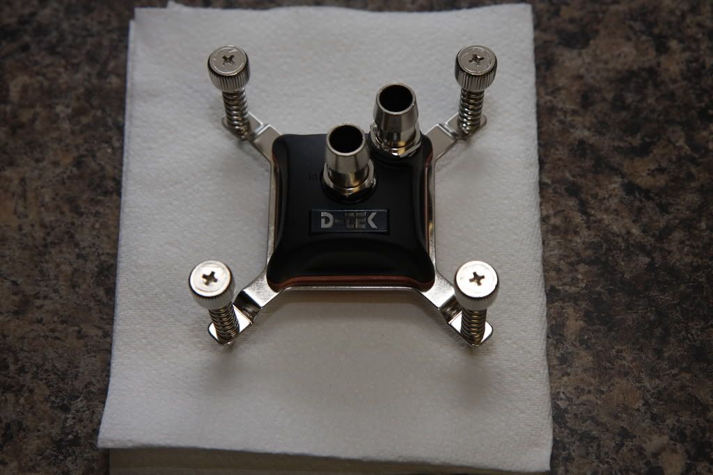

After nearly two months, the D-Tek 1366 mount is ready. And here it is:
http://i7.photobucket.com/albums/ww2...n/IMG_1978.jpg
Looks pretty awesome, and works well. I was not planning on running my water loop on plain distilled water for this long. Plants and fish started to take over my loop :shakes: My water block was dark green, but a few minutes in the vinegar turned it nice and shiny. Unfortunately, I took no pics of it.
http://i7.photobucket.com/albums/ww2...n/IMG_1979.jpg

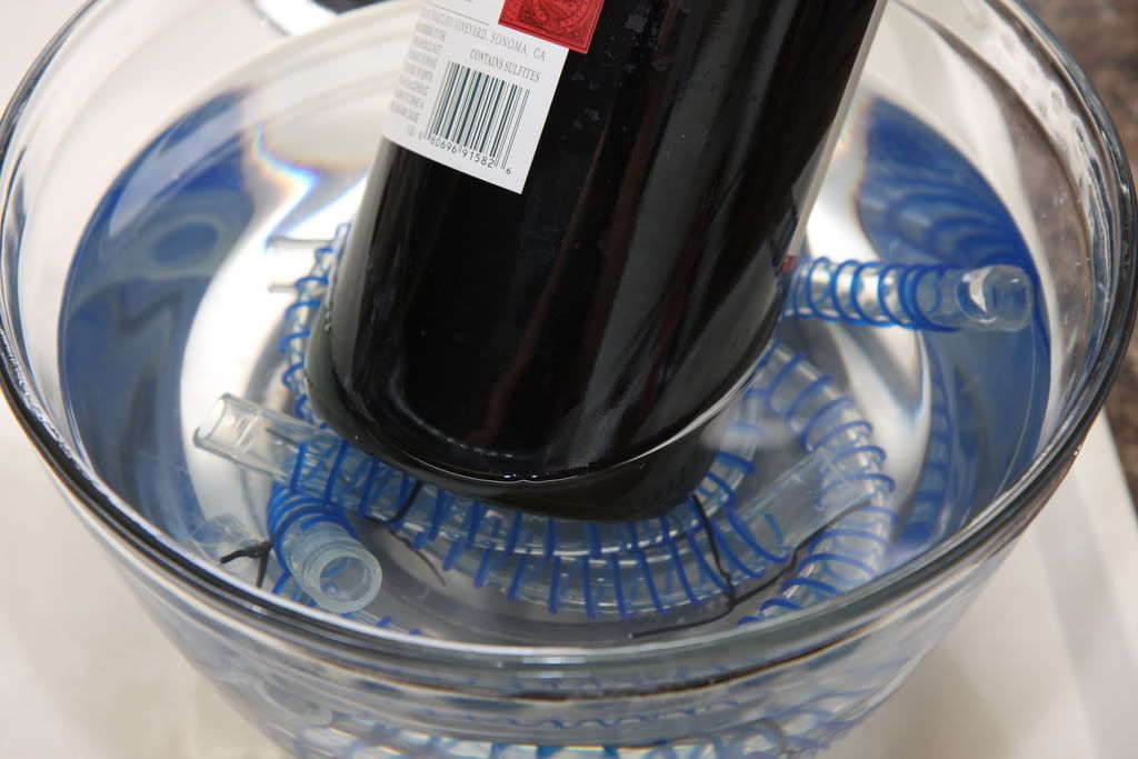

My tubes were also turning a bit muddy, so I've soaked them in 50% vinegar + water... Cleaned it up real fast.
http://i7.photobucket.com/albums/ww2...n/IMG_1980.jpg

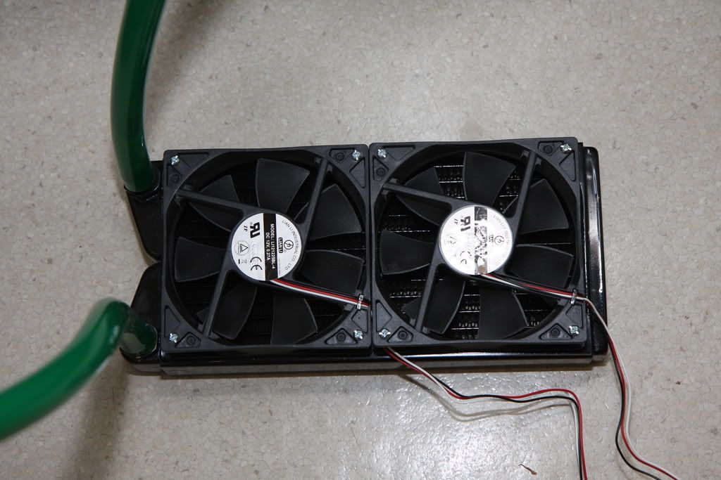

Likewise, I used a little vinegar for the radiator. And here's the deal:
http://i7.photobucket.com/albums/ww2...n/IMG_1982.jpg

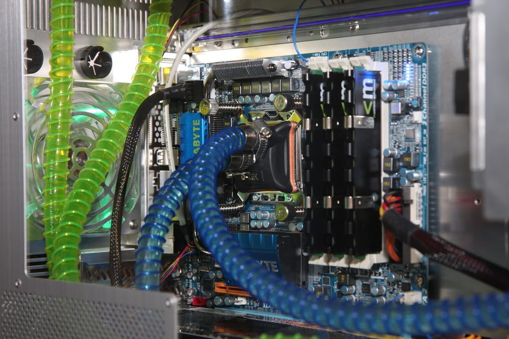

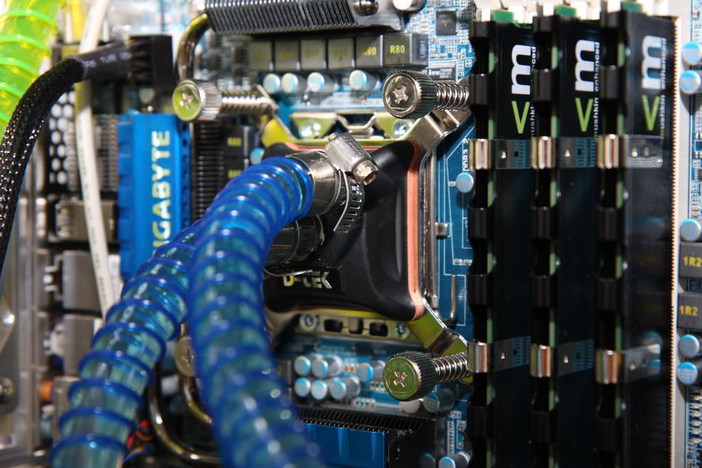

D-Tek Fuzion V2 with 1366 pro-mount. The backplate pretty much stays in place, so you can remove the block without removing the motherboard every time as well.
http://i7.photobucket.com/albums/ww2...n/IMG_1983.jpg

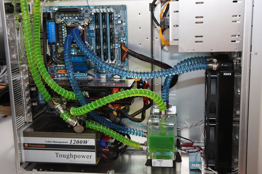

All the cables hidden behind the motherboard backplate. It was a challenge to squeeze them in there...
http://i7.photobucket.com/albums/ww2...n/IMG_1995.jpg

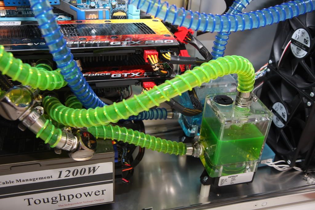

Pumps & video cards.
http://i7.photobucket.com/albums/ww2...n/IMG_2000.jpg

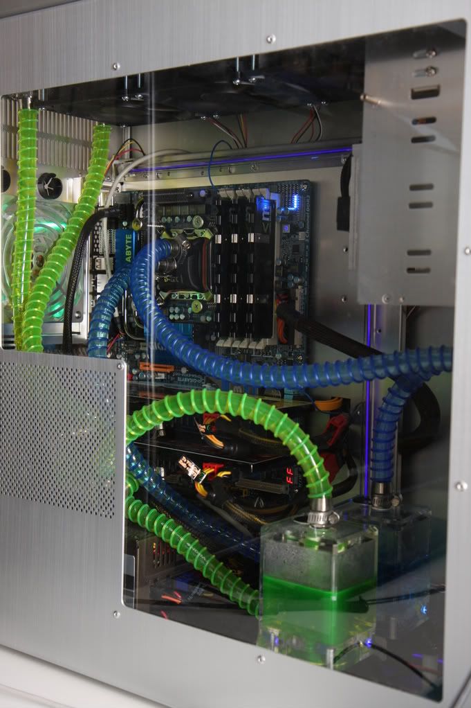

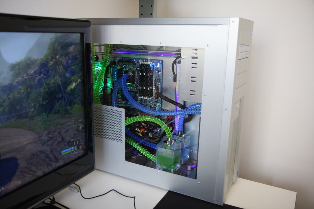

View through the side window.
http://i7.photobucket.com/albums/ww2...n/IMG_2007.jpg

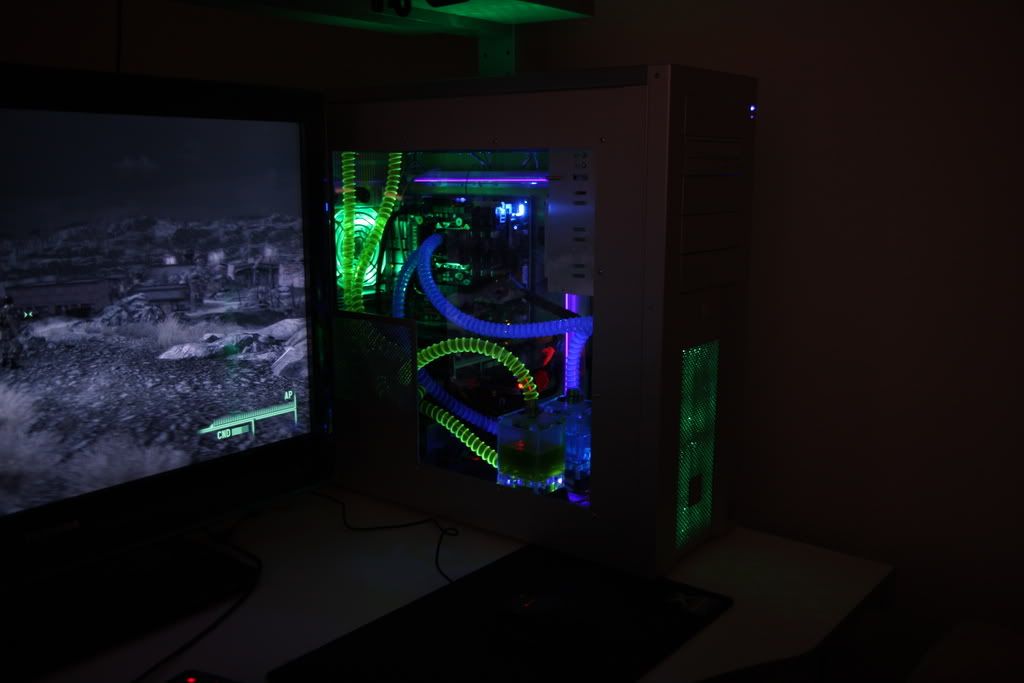

Glowing... I declare the project complete until the next upgrade :wiggle:

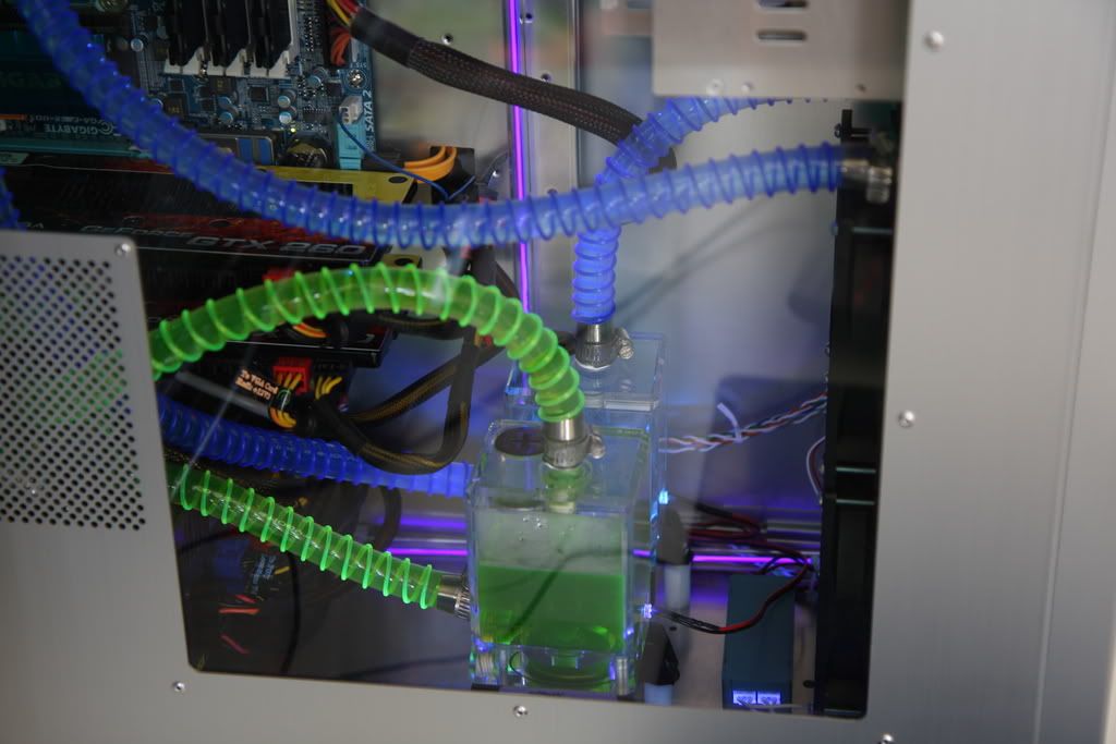

Wow, looks great! With regards to the shot of the green tubes going into your rad...is that what color they had gotten to? :eek:
No, my GPU loop has Hydrx in it :) The green glow is by design. It did not have the same issue as the plain water loop. All you could see was that the tube turned a bit more murky, but only if you looked close.

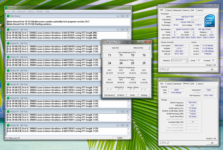

On another note, my temps dropped significantly. I can now hit 4.1GHz with HT on and 1.425 VCore and my temps are still lower than with the zip-tie mount.
http://i7.photobucket.com/albums/ww2...n/41_HT_On.png
4.2GHz with HT on takes 1.475 VCore in the bios. I could not get there with the zip ties, but the new mount keeps my temps better in control. Might try to go for that later. For now, I've decided to stick with 21x195 for 24/7 use.
I've found the final settings for my video cards as well, 756 core/1512 shader/1269 memory. I'm limited by the shader setting as once I increase that, Furmark crashes. I got 61 C max after 45 minutes Furmark, so no heat issues with the video cards either.
