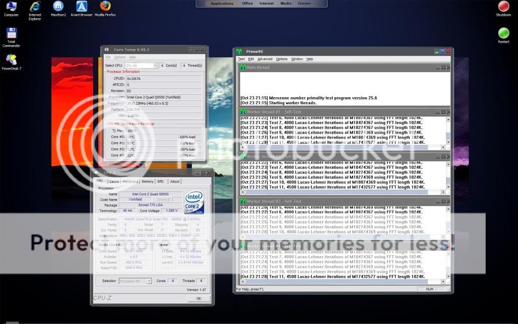

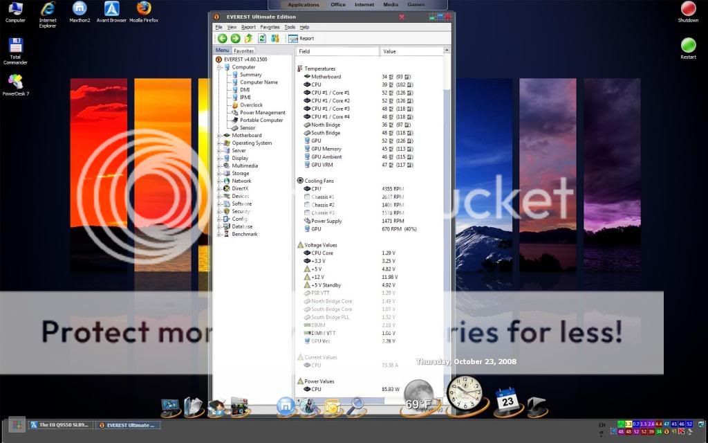

Nice, even < than my E0 which is 1.1/1.1625v, your clocks show that there are really good C1s out there too. :)
I could do 24/7 3.8Ghz easily, but meh 3.6Ghz and 3.8Ghz cant see any difference :p:
One thing that keeps :confused::confused: me is my VID, it should be "THE" stock voltage on load?!
But still i get this
http://www.aijaa.com/img/t/00342/2890165.t.png
1.16 on load! :shrug:
http://www.aijaa.com/img/t/00763/2890208.t.jpg
And my real VID is a 1.2500 according real temp!
Yeap, in week always when i get home from work my rooms temperature is +21c and then when i am going to sleep its on 26c :cool:
1.16 seems even stable :eek:
http://www.aijaa.com/img/t/00026/2890322.t.jpg
haha 0.9 would be great :D

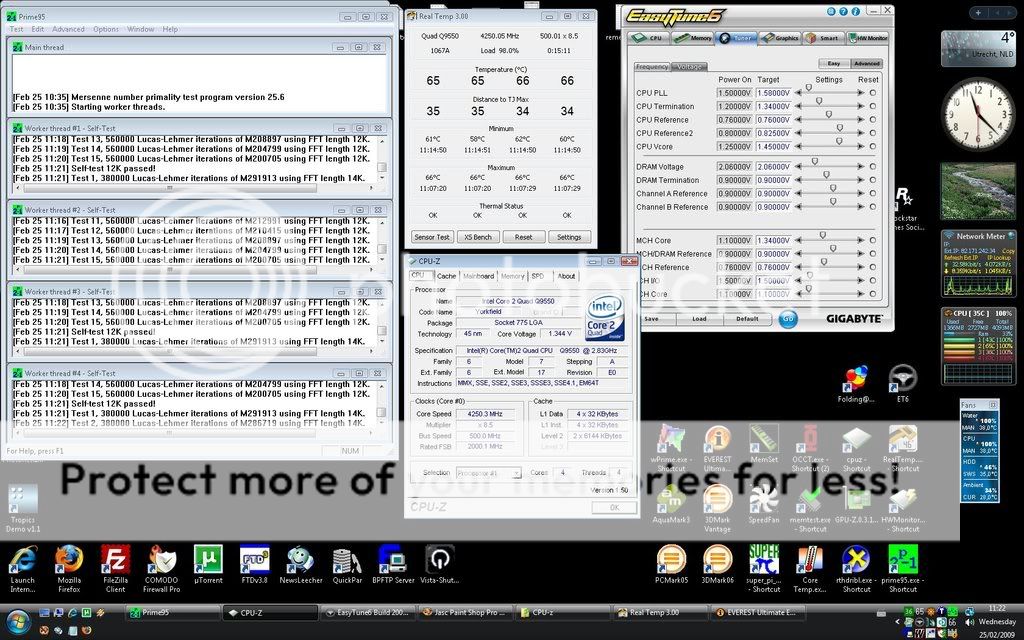

But... On my situation auto on stock is 1.16 on load, still all programs says that VID is 1.25 :shrug:
On this C1 Stone i can run stable at 1.25 max 3.5Ghz, 3.6Ghz needs 1.27
1.16 is the Vdrooped reading... 1.25 VID is THE BIOS related voltage setting taking into account VDROOP which is part of intel's CPU spec.

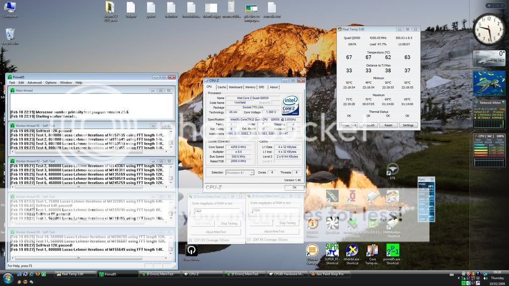

Here's mine. Batch is L830B421, VID of 1.2375.
Lowest volts at stock speed, 1.040v idle, 1.008v load:
http://upload.overclock3d.net/dwn/31...d06_stable.jpg
http://upload.overclock3d.net/dwn/01...ime_stable.jpg
What I'm running now, 4.05GHz, 1.304v idle, 1.248v load
http://upload.overclock3d.net/dwn/01...5_1248v_3d.jpg
http://upload.overclock3d.net/dwn/31...248v_prime.jpg
Very happy with this chip. I managed to boot into Windows at 4.25GHz with 1.392v, but cause of the terrible vdroop of my board, it froze when I started prime as the volts dropped down to 1.336v.
