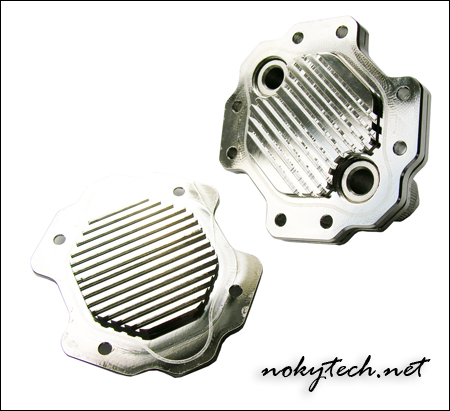

Then take a breath and analyze the flow pattern to see where water will go preferentially (almost directly from one barb to another using the straight channels on the top, not the bottom ones) :
http://www.petrastech.com/blogimg/maze-g-flow.jpg
Draw your own conclusions ;)
So lemme guess this.
The water flows from barbs to chanels. Those chanles align up? they stacked next to each other or cris cross? wouldnt that kill your flow?
We can ignore the top piece as it wont aid in thermal transfer.
But the bottom piece looks like a thick slited base. Also the layout would lead me to assume its not bowed? if it was bowed you'd get cracks in between the two plates when the bases aligned.
I dont get this block. :shrug:
Expecially the 125 dollar price tag with it. Id rather pick up an AquaComputers DI Cuplex over it at that price.

NaeKuh > Channels are criss-crossed.
